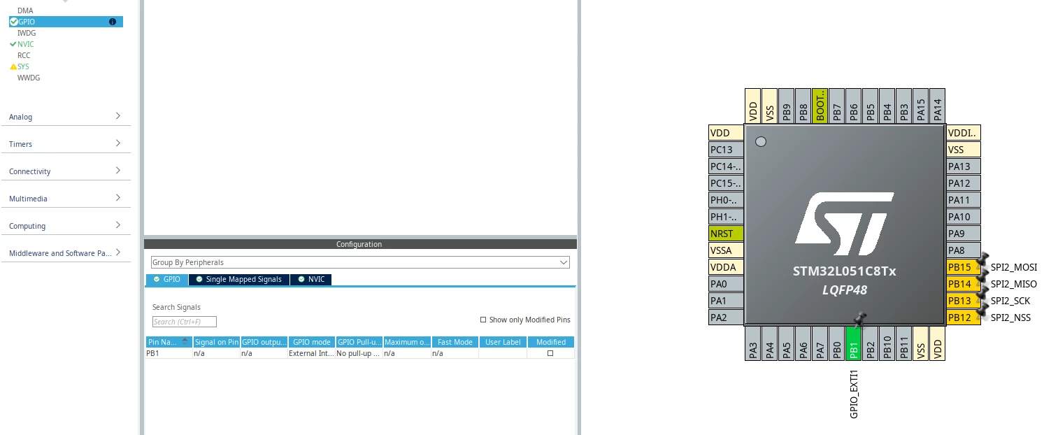

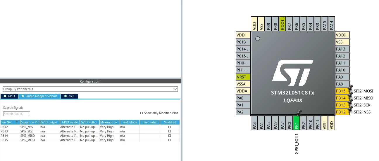

I may be missing something, I cant generate the SPI_init() method within main() (also pins are yellow ?)…
I have generated;
  HAL_Init();
SystemClock_Config();
MX_GPIO_Init();
Cheers

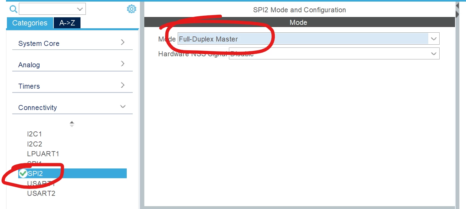

Yellow pins mean the peripheral isn’t enabled.
In the SPI2 peripheral, enable it by choosing a mode such as two-way master.
1 reply
