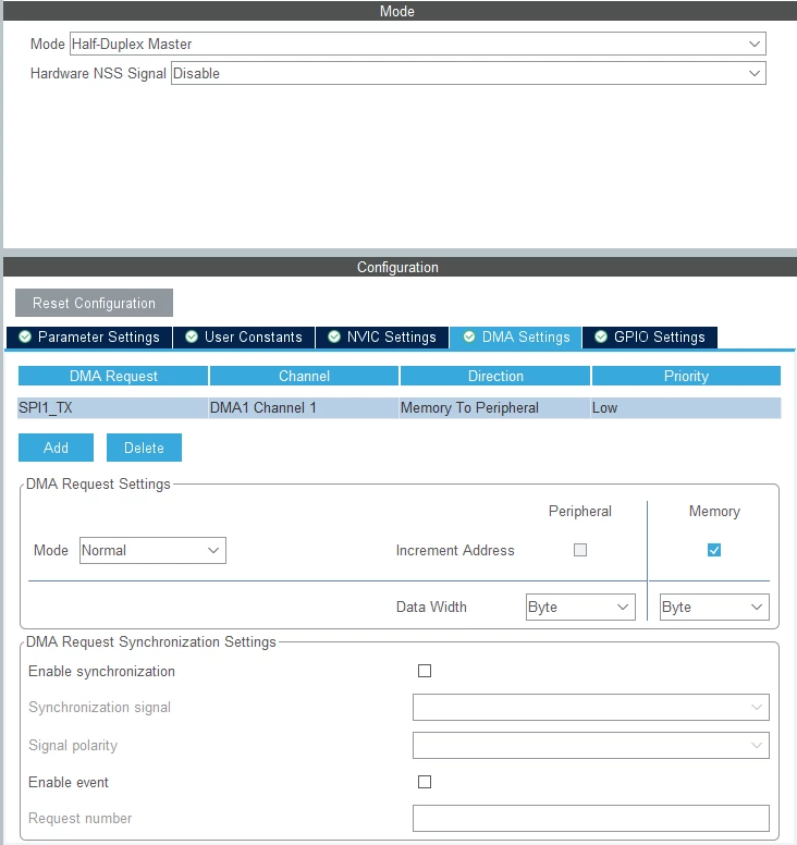

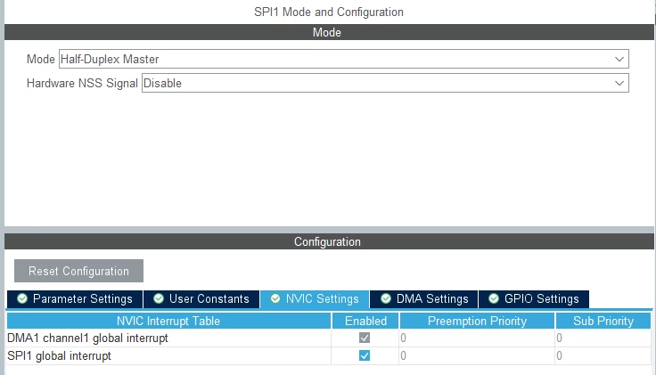

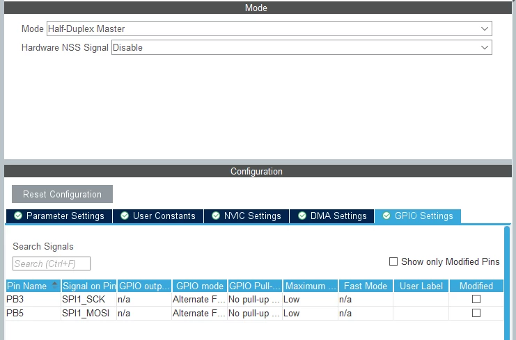

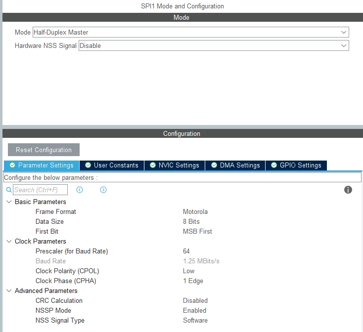

I am trying to setup the ST7735 Display (ST7735) with SPI and DMA for a faster refresh rate. Without DMA everything works fine. When i setting up DMA nothing is displayed on the Display.
My DMA and SPI Settings are:

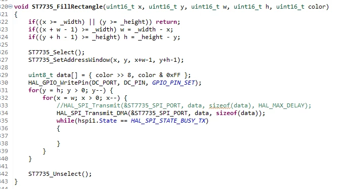

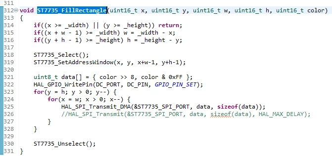

I want to fill the Screen with black color, for this i use the function fillScreen() from GFX_FUNCTIONS.c. To Transmit the data via DMA i have replaced the old functions in ST7735.c with the DMA Transmit function in ST7735_FillRectangle(), ST7735_WriteCommand() and ST7735_WriteData().

I guess the issue is where you put in a loop to write the DMA request.. Here you have to wait for first DMA to complete before sending the next request. You need to use HAL_DMA_PollForTransfer() function to check if the previous DMA is complete or not. Alternatively, you need to enable the SPI and DMA  interrupt and use void HAL_SPI_TxCpltCallback (SPI_HandleTypeDef * hspi) to write the bytes, but then the logic has to be re-arranged.

This helps. I have adapted my code as follows:
Thank you!

Seems you completely misunderstand how DMA works and where you read , that one pixel DMA make better refresh rate??? Your DMA code when works after mistakes removed, will slower as original without DMA.
