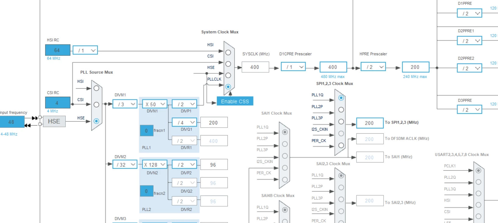

> nucleo H755ziq
> external 48mhz crystal
This board doesn't have a 48 MHz crystal. It does have a 8 MHz clock source from the ST-Link chip which is connected by default. Note that 8/48 = 0.1666 so maybe your clock source is just wrong (HSE_VALUE).

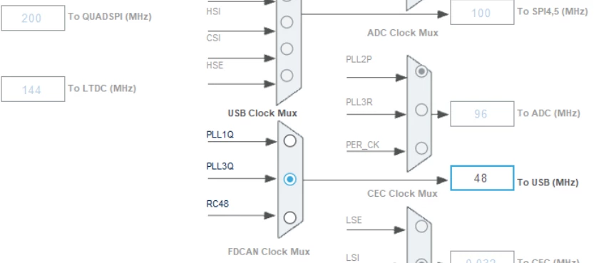

It's an external ADC bc of a project Im working on that I can't specify more about. It's a custom ADC is as much as I can say. The important part is that, when checking the speed in the code, it shows the correct speeds of 100mhz for the spi (simply checked with HAL_RCC_GetPCLK2Freq()). meanwhile the logic analyser shows the speed of 60ns per clock cycle which suggests a 16.667mhz speed instead. It's like a 6x prescaler is added on or something.

Could you share with us your system clock config please?

IgneousAuthor
Mar 21, 2025 12:16 PM UTC
this should do for that
