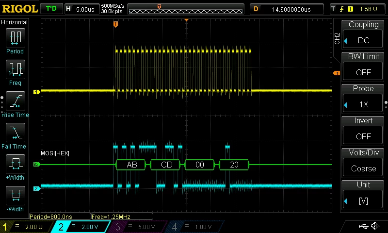

I've configured the STM32F103C8 for 16-bit data transfers. On the scope I can see my 16-bit data which is followed by some garbage data that the MCU is not configured to send. Am I mis-configuring something? How do I ensure that only 16-bits are sent? Here is my code in main.c: I've not included all the other bits about clocks and gpios. Please let me know if you'd like to see those as well and I'll attach them here.

This is how the SPI is configured:

This is what I see on the scope:
0690X0000060LYfQAM.png #16-bit-spi #spi-communication #spi-master-mode #hal-spi

Posted on June 30, 2018 at 22:34
Try changing:
sizeof(tx_temp)
...to '1'.

Posted on July 01, 2018 at 10:14
Thank you. That worked!
Suggests that HAL_SPI_Transmit takes a count of units to transmit, not bytes, right
HAL_SPI_Transmit(&hspi1, &tx_temp, sizeof(tx_temp)/sizeof(uint16_t), HAL_MAX_DELAY);

Posted on July 01, 2018 at 10:15
Thank you for that clarification. I wasn't aware of that.
