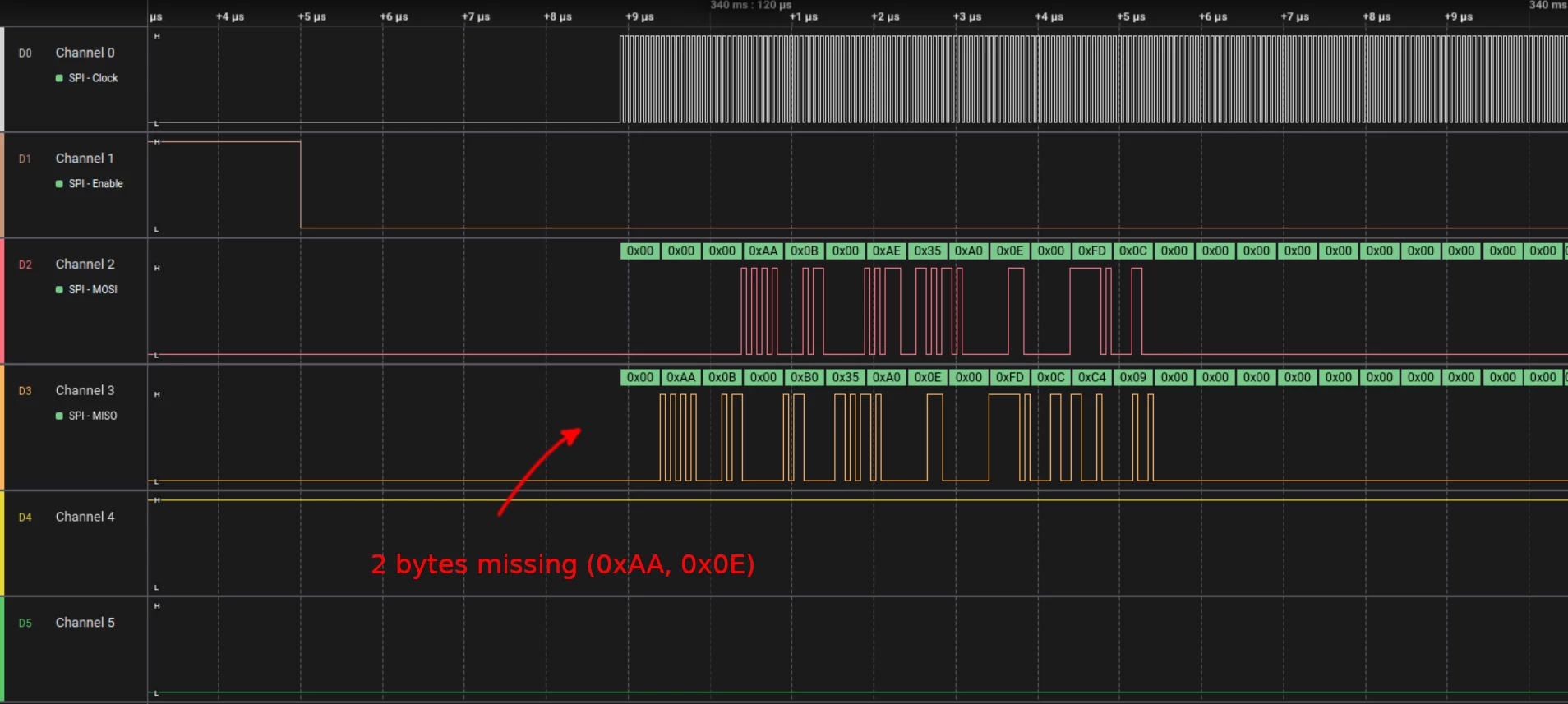

I have an optimized SPI Slave DMA setup which is driven by the chip select interrupt. It looks something like:

This works 99.9% of the time, but occasionally `handleTransferStart` gets delayed by a couple microseconds.
This is okay because the master can detect the invalid data and re-try the transfer. My issue is that something gets out of sync in the TX DMA / FIFO. Here is my attempt to fix it:

Oddly this works for the first failure, but fails all subsequent attempts:
EDIT: I changed my code to write 3 * 0xFF to the txFIFO and I still see the same thing so it's more than just the first 2 bytes missing...

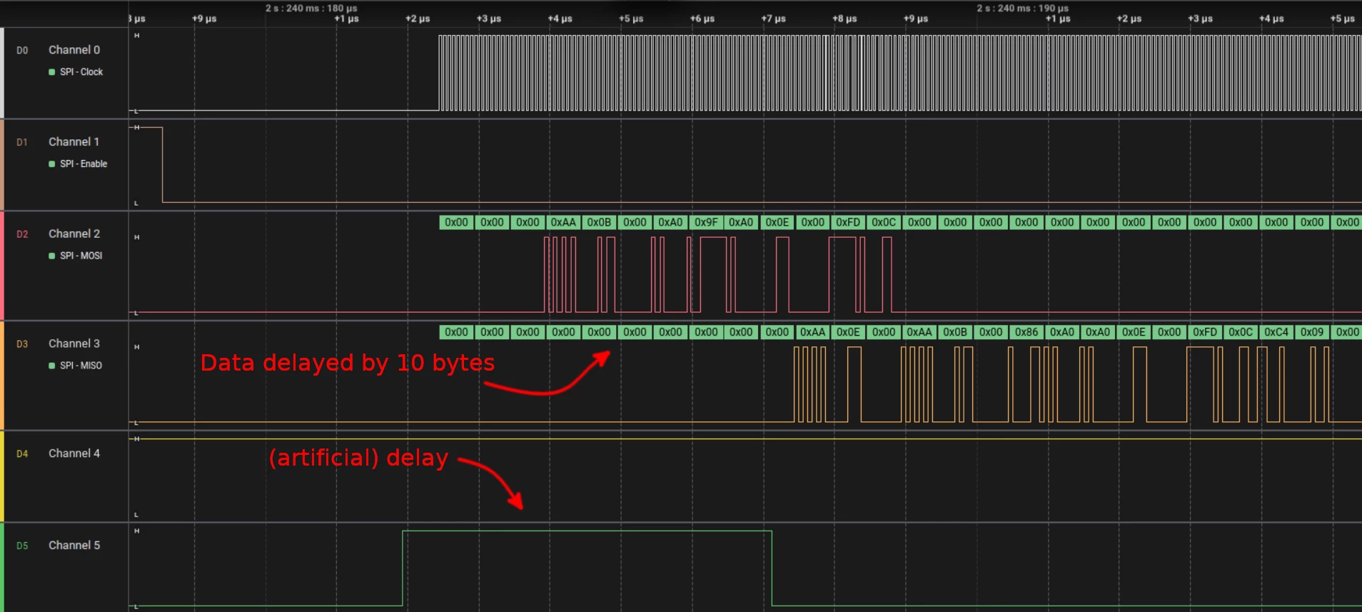

I also tried writing different lengths to the CM0AR in the retry:

In this case the MISO line looked good every time, but as expected there were always 3 bytes remaining in the FIFO so my "resend / recovery" condition triggered indefinitely. Not checking the FIFO level put things out of sync again for some reason.
I've played around with several other things like not writing directly to the FIFO, using CNDTR sizes well below SPI_FRAME_SIZE but it always seems to end up out of sync by 1-2 bytes.
My current solution is to remove `handleTransferStart`, but this requires the master to perform 2 transfers to get a response to and data it writes due to the double buffering.
