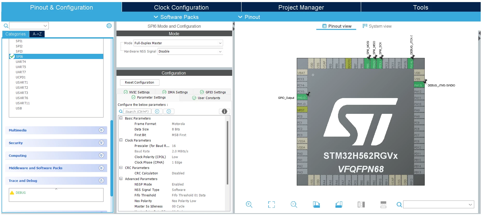

Iam using STM32H562RGV6 for my project and iam using SPI6 on this MCU in order to communicate with LSM6DSOX which is an IMU from ST itself but i couldn’t get proper data from the IMU, as its giving random data sometimes and sometimes its zero.
Pin connections :
SPI6_SCK  -> PB3
SPI6_MOSI -> PB5
SPI6_MISO -> PB4
CS  -> PH0 (This is an external crystal oscillator pin but iam using it as GPIO, Will this be an issue as on this pin even if i set the GPIO to high its giving a maximum voltage of 1V)
I tried to change the CS pin instead of toggle before and after communication to ground always and used pull-up in cube ide also but nothing seems to work as i cant communicate and get proper data , chip id itself.

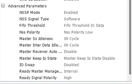

Here are my SPI6 configuration settings of my project, I changed the prescalar to different values but nothing is working. When I measure voltage on SPC and MOSI pins its giving 1.35V (If this would be an issue)
How to debug this issue i dont have print log iam just using Debug windows live expressions for checking change in values.

I can't see neither your GPIO configuration nor the clock system setting. Are you sure your external clock source is disabled? I don't understand what does it mean CS->PH0 and how it is related to SPI as PH0 pin should not be dependent on any SPI configuration. Note if enabled, an additional function always prevails any alternate one.
It would be helpful to double check GPIO configuration registers of the problematic pin and  RCC_CR especially.
Your SPI configuration includes few contradictions evidently at least, too. You have enabled SS pulse mode which uses HW output by default while its control is set to SW mode. Anyway, to force interleaving pulses between the data frames you need to set data interleaving > 1. Applied setting it to zero makes no sense.
