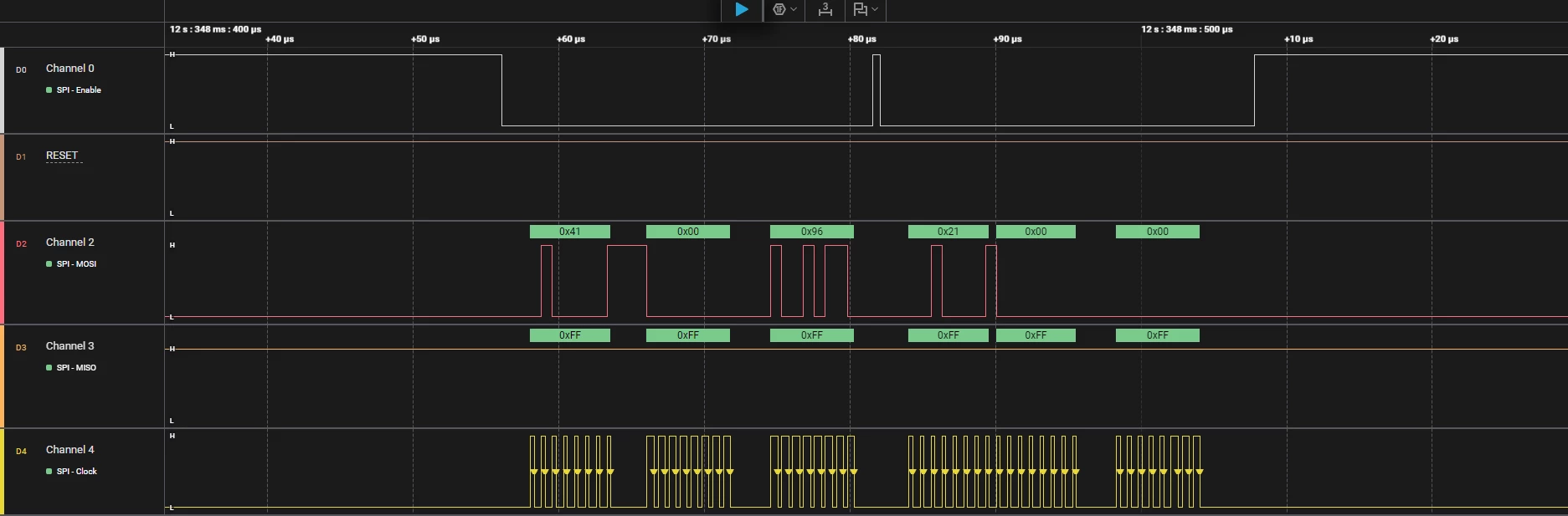

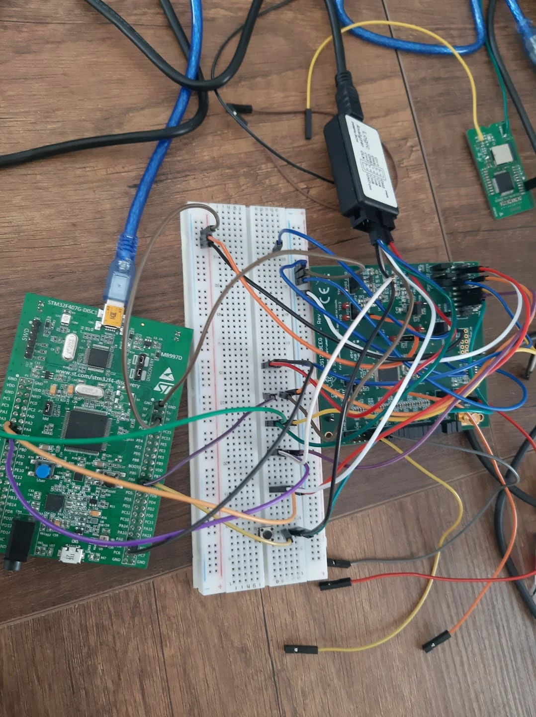

How is it wired? Show pictures. MISO at 0xFF or 0x00 generally indicates wiring is not as expected, or pins are already in use, or some other setup issue.
OmerbzktAuthor
June 19, 2025
I am connecting pins using a breadboard. I tested the pins with a short circuit test all of them are connected. I am supplying AVDD and DVDD with 3V. Thanks for your reply @TDK
June 19, 2025
Hello @Omerbzkt
Please use a short cable with wire wrapping to connect your device
In order to give better visibility on the answered topics, please click on 'Best answer' on the reply which solved your issue or answered your question. Saket_Om

What pin is used for MISO? Is it in use by something else on the STM32F407G-DISC1 board? If you set that pin to output push/pull and disconnect from the ADS chip, can you toggle it and observe on the scope?
If you connect MOSI to MISO, do you read back the same data you're sending out?
OmerbzktAuthor
June 19, 2025
I am using PA6 as a MISO pin. The configuration for the MISO,MOSI and SCK
is the default configs for the SPI. I tried readback operation and I can
see same message that I sent. Did you see any misconfigutation in the code?
June 19, 2025
No, I don't see any misconfiguration in what is presented. I suspect it's a hardware issue, not software. STM32 seems to be doing its job.
