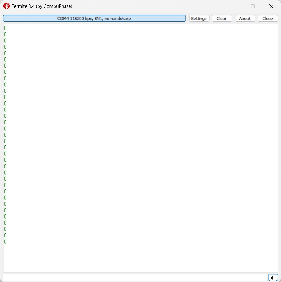

On the slave, the HAL_SPI_RxCpltCallback() and the code inside it (setting a flag) are being executed, meaning that the slave is attempting to receive data sent by the master. However, the data in the SPI receive buffer is always 0x00 (serial terminal shown below; displaying "0" for every SPI receive interrupt occurrence).
Termite serial terminal outputting "0" upon every occurance of SPI receive interruptTermite serial terminal outputting "0" upon every occurance of SPI receive interrupt
I need to have the master and the slave operating in Full-Duplex Master and Full-Duplex Slave modes respectively (both with interrupts), however, when setting them in Transmit Only Master and Receive Only Slave, and disabling interrupts, for debugging purposes, the same issue persisted.

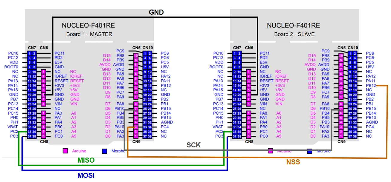

Below are the hardware connections (short wires from one NUCLEO board to another):
  • SPI2_SCK on PB10 of NUCLEO-F401RE Board 1 (MASTER) -> SPI2_SCK on PB10 of NUCLEO-F401RE Board 2 (SLAVE)
  • SPI2_MISO on PC2 of NUCLEO-F401RE Board 1 (MASTER) -> SPI2_MISO on PC2 of NUCLEO-F401RE Board 2 (SLAVE)
  • SPI2_MOSI on PC3 of NUCLEO-F401RE Board 1 (MASTER) -> SPI2_MOSI on PC3 of NUCLEO-F401RE Board 2 (SLAVE)
  • GPIO_Output on PA10 of NUCLEO-F401RE Board 1 (MASTER) (controlled through software) -> SPI2_NSS on PB12 of NUCLEO-F401RE Board 2 (SLAVE) – I need this because when I get this to work with one slave, I will move on to a multi-slave system
  • GND of NUCLEO-F401RE Board 1 (MASTER) -> GND of NUCLEO-F401RE Board 2 (SLAVE)
Connection diagram of the two NUCLEO-F401RE boardsConnection diagram of the two NUCLEO-F401RE boards

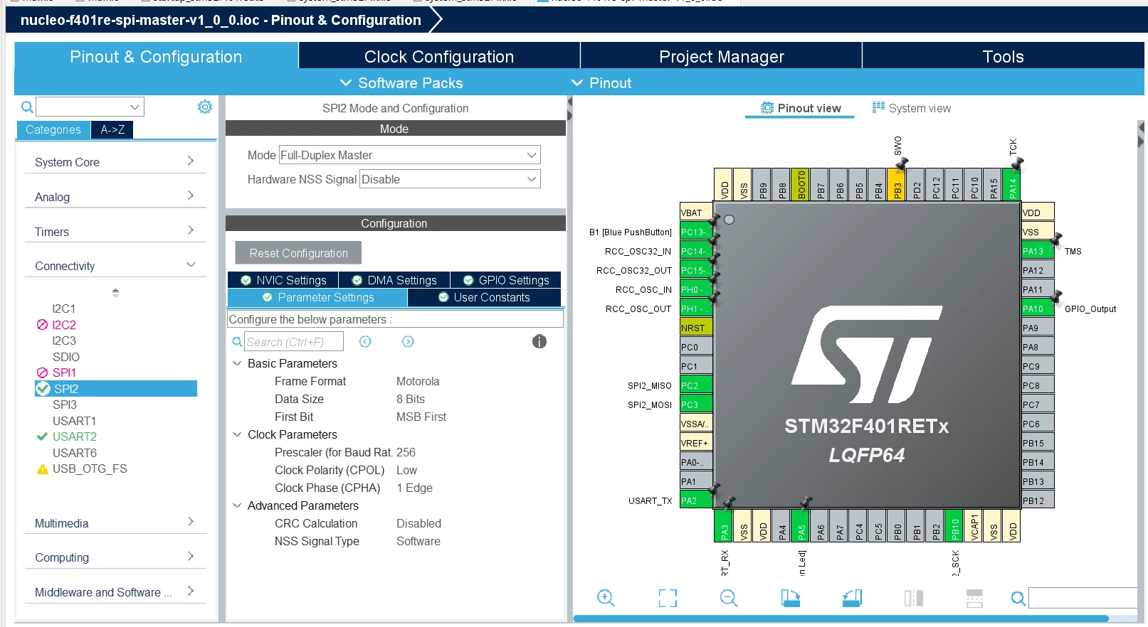

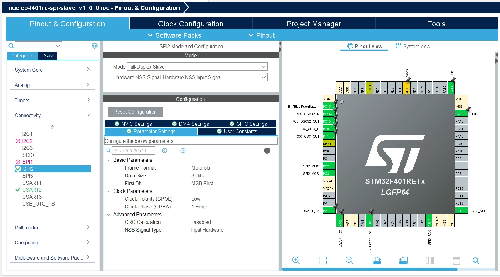

Attached are the Master and Slave configuration settings in STM32CubeIDE Code Configurator.

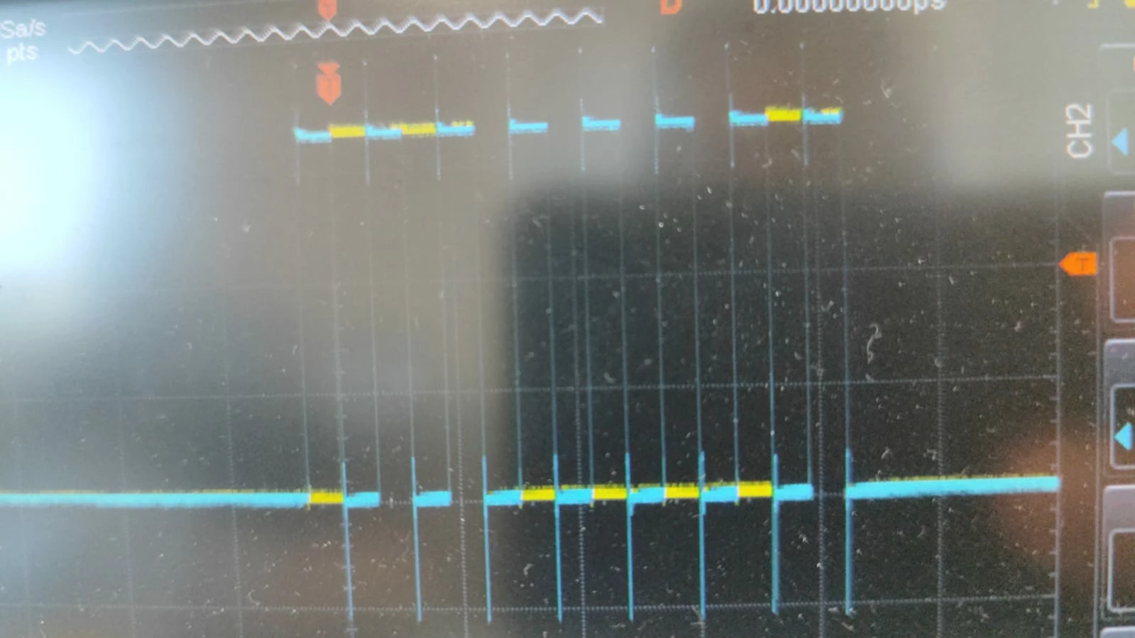

I checked the SCK, MOSI and NSS signals using an oscilloscope, and nothing looks wrong there, so I believe the problem lies within the slave's receiving data code... MOSI and SCK signals shown below and are in synch, with MOSI showing bits for 0x61 one-byte message transmitted by the Master (apologies for the bad image quality, I'll try to update the picture ASAP)... NSS signal has also been verified.
Photo of scope showing SCK signal (blue) and MOSI signal (yellow) during transmission of 0x61 single-byte messagePhoto of scope showing SCK signal (blue) and MOSI signal (yellow) during transmission of 0x61 single-byte message

Andrew Neil
Mar 24, 2025 2:40 PM UTC
Never a great idea to try to do both ends of a link at the same time.
https://community.st.com/t5/stm32-mcus-products/two-nucleo-boards-stm32f446re-and-stm32h723zg-communicate/m-p/737695/highlight/true#M264992
Have you looked at the SPI lines using a scope and/or logic analyser to see what (if anything) is happening?
It's a lot easier to show connections as a diagram, rather than text.
Hand-drawn or ASCII-art is fine ...

Mar 24, 2025 3:30 PM UTC
Hi @Andrew Neil, thanks for your comments.
You're right. But given that I had previously used the functions HAL_SPI_Transmit_IT() and HAL_SPI_Receive_IT on an identical NUCLEO-F401RE board without any problems, I thought that implementing them to communicate with another STM32 board instead of SPI device such as an IMU, would be straight-forward. Moreover, scope shows correct bits for the single-byte message 0x61 the Master is transmitting (and is correctly synched with SCK), so master appears to be transmitting fine.
I'll have a look at the link you shared; thanks.
I have drawn a diagram and included it in my original post... Thanks for suggesting!

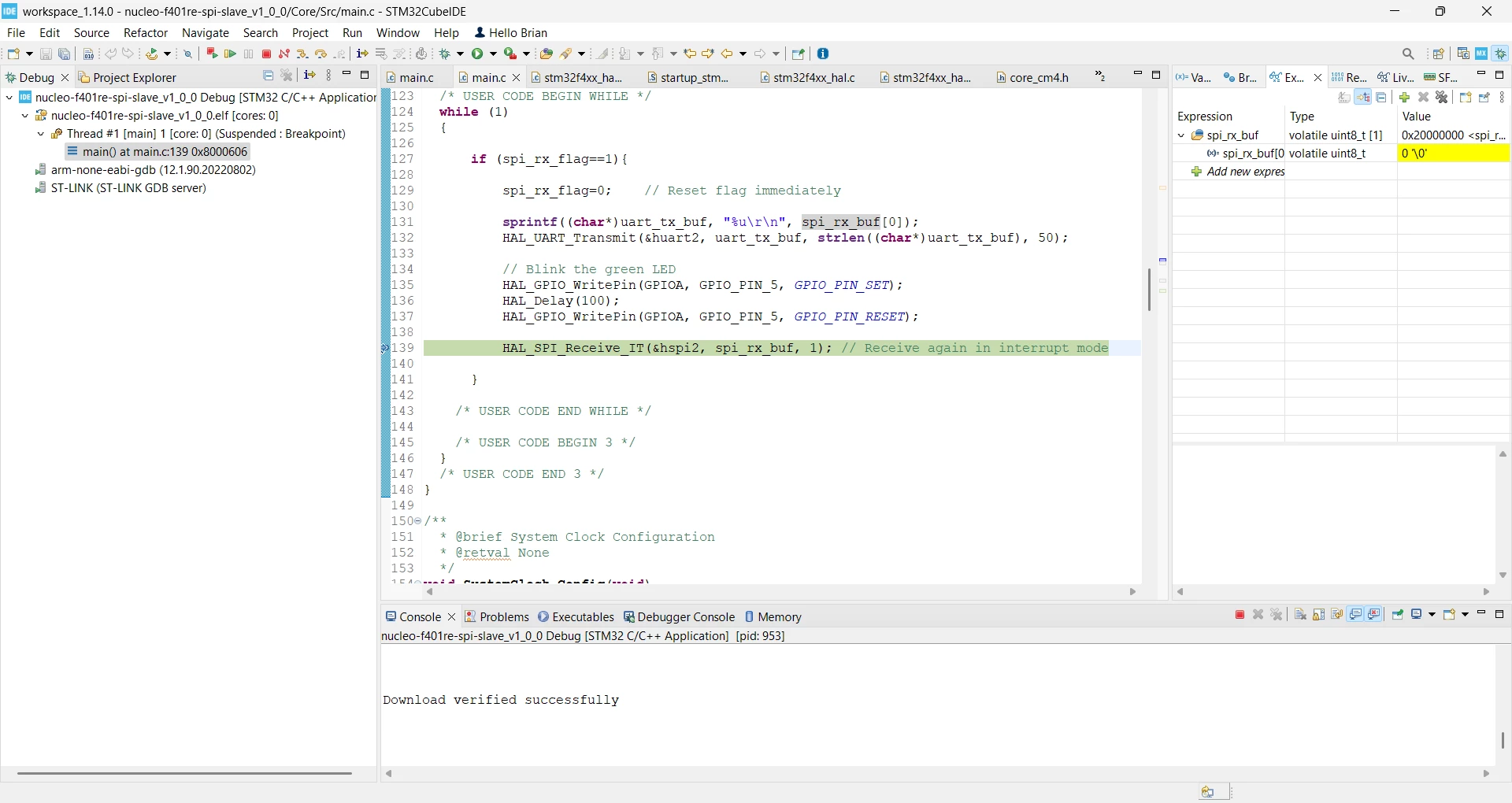

Mar 24, 2025 5:34 PM UTC
Hi @TDK ,
I have initialized spi_rx_buf with the value 0xAA and placed a breakpoint in while(1), within the if (spi_rx_flag==1) statement. Recall that spi_rx_flag is set to 1 in the SPI RX callback.
The value of spi_rx_buf is changing to 0x00, confirming that the SPI RX callback is being executed, and that 0x00 is being written to the buffer spi_rx_buf.
Breakpoint debugging and spi_rx_buf whose value is changing from 0xAA to 0x00Breakpoint debugging and spi_rx_buf whose value is changing from 0xAA to 0x00
Could it be that the MOSI signal is not being sampled right, i.e. it is being sampled when the line is low, and thus resulting in a 0x00 value?
