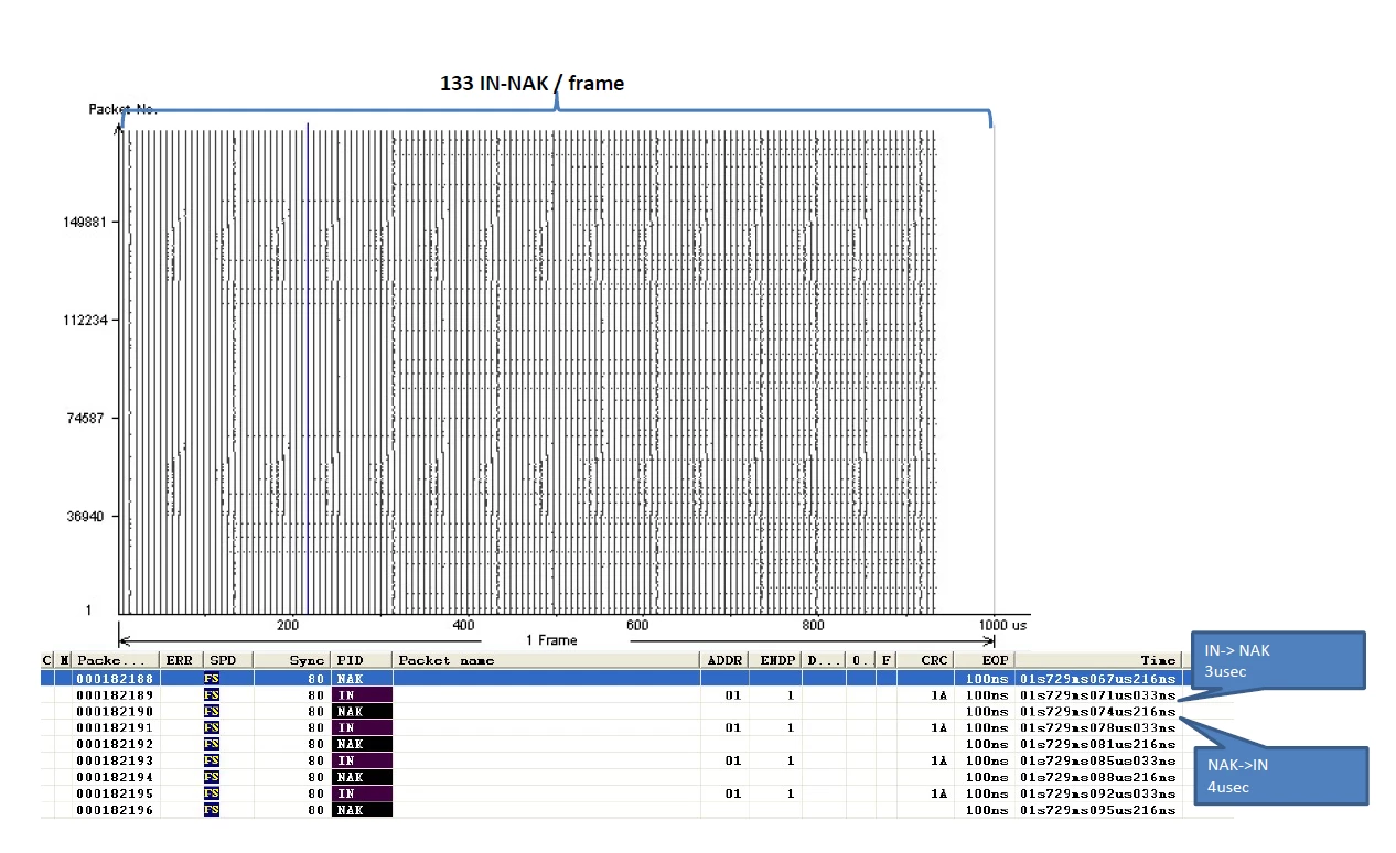

1. I wondered why the DBCDNE interrupt is useful even if it doesn't use the HNP/SRP function, but why it is so designed.
(I implemented Debounce period wait using an external timer. )
2. It seems that the processing of NAK reception is not described in the section of the programming model of RM. Thanks to you, I have confirmation.
3. Regarding this, it was a rudimentary mistake to use a pile of IF statements to identify the interrupt factor in the ISR.....
I tried to make the number of cycles to clear NAK interrupts as short as possible in the ISR, and I was able to raise it to 133 IN-NAK polls per frame.
As related to Question 2, it was found that the response performance of the SW greatly affects the communication efficiency because the SW must handle the processing of the subdivided granularity.
The attached document is the acquired IN-NAK polling log.
The software load will be heavy, it may be possible to further improve the polling frequency.
