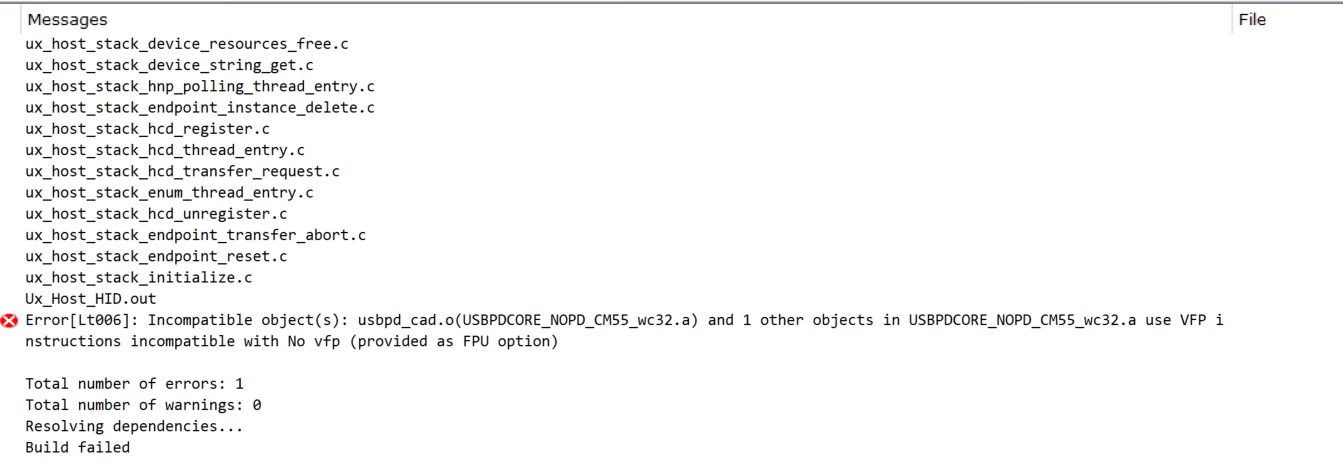

I am trying to compile some USB examples for the Nucleo-STM32N657X0-Q board that is available with the STM32CubeN6, but they are failing.
All USB examples at this location do not compile with IAR
STM32Cube_FW_N6_V1.0.0\Projects\NUCLEO-N657X0-Q\Applications\USBX
It seems to be related with the following library(USBPDCORE_NOPD_CM55_wc32.a) adding FPU instructions, when the MCU does not support it.
Is there an updated version for the STM32CubeN6 SDK that solves this problem?

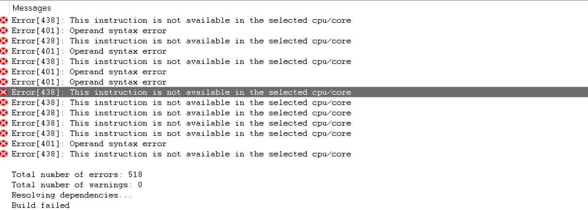

Compiling with EWARM v9.60.3 I get the error shown on image IAR 9.60.3 compile Error.PNG

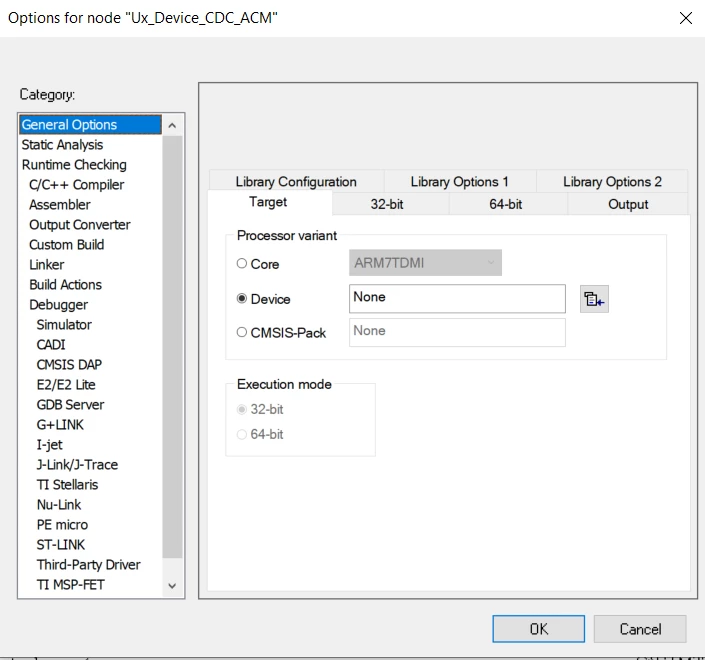

I assume you have a modify 9.50.2 version for IAR because I also downloaded the same version  and the compiling result shows too many errors(IAR 9.50.2 error.PNG), which is probably due to the version not supporting STM32N6 series as shown on image IAR 9.50.2 default configurations.PNG

I forgot to add the image for IAR 9.50.2 default configuration of the project on my last post.
