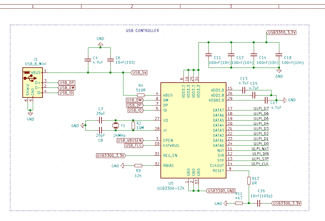

I am in the process of power on my custom board.
Right now I'm trying to get the USB to work but I'm stuck and don't know what to do next.
I use USB midleware from CubeMX 6.1.2
The moment I have everything configured and run the interrupts I get the one interrupt with flags:
USB_OTG_GINTSTS_USBRST and USB_OTG_GINTSTS_USBSUSP.
While handling the suspend handler my micro controller is restarting
(The restart is caused by operation: __HAL_PCD_GATE_PHYCLOCK(hpcd) in usb suspend handler)
I checked the voltages and waveforms of crystal lines and ulpi clk line and everything seems to be ok.
Here is the USB3300 wiring diagram:
0693W00000D1pcUQAR.pngThanks

Someone already stated on this forum that if something went wrong with USB330 it was HW's fault . I tested 4 USB3300 controllers and only the 4th one worked.
Solved!

Aug 8, 2021 4:13 PM UTC
The code in question stops the clock being sent to the USB chip.
https://github.com/STMicroelectronics/STM32CubeH7/blob/ccb11556044540590ca6e45056e6b65cdca2deb2/Drivers/STM32H7xx_HAL_Driver/Inc/stm32h7xx_hal_pcd.h#L204
I don't see how stopping the clock would end up resetting your chip.
How is your NRST wired? Do you have a 0.1uF cap on it? Maybe using a scope on the NRST signal would prove insightful. Not really sure what it could be.
