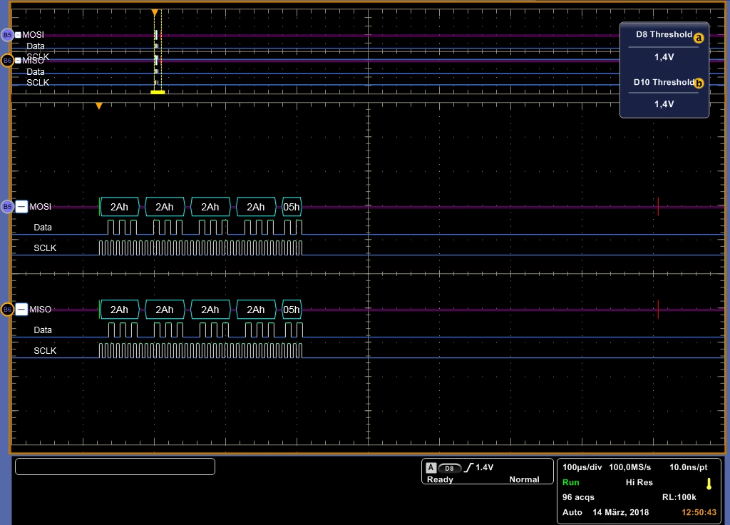

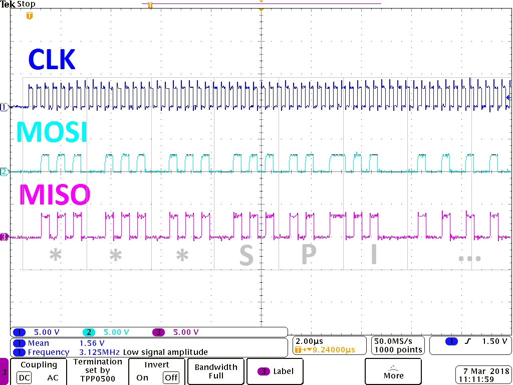

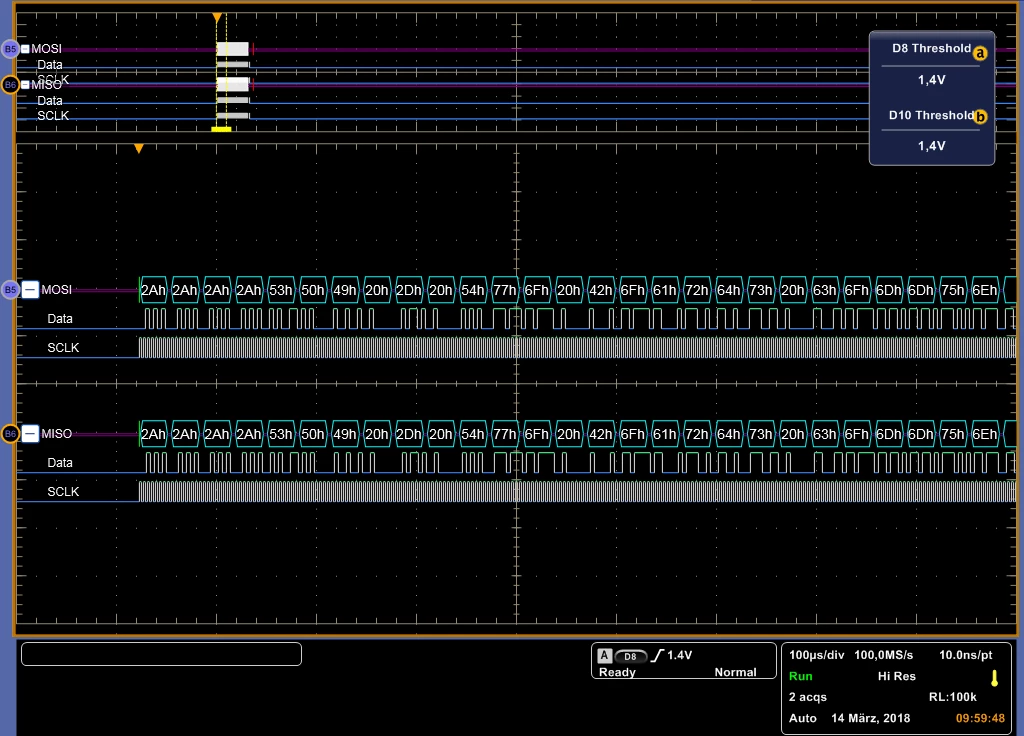

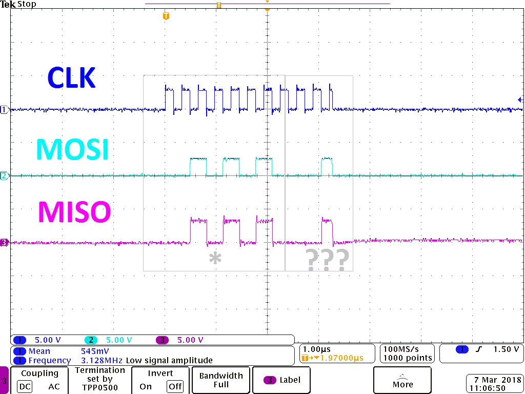

I have made connexion wires as short as possible and I have increased spi clock prescaler to get ''slow, nice and smooth'' signals. Electronic not seems to be the problem. I have modified the example to run it without DMA by replacing :
HAL_SPI_TransmitReceive_DMA(&SpiHandle, (uint8_t*)aTxBuffer, (uint8_t *)aRxBuffer, BUFFERSIZE)�?�?�?�?�?�?�?�?�?�?
With :
HAL_SPI_TransmitReceive(&SpiHandle, (uint8_t*)aTxBuffer, (uint8_t *)aRxBuffer, BUFFERSIZE,5000)�?�?�?�?�?�?�?�?�?�?
And now it's working! But not with the DMA .... This test shows that SPI is set and works correctly. aRxBuffer is filled with the good values.

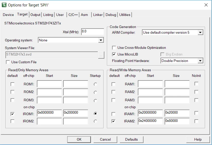

I've just found the difference between the HAL Nucelo example projects and the CubeMX generated projects.The problem for the DMA transfer error is that we use the false RAM!!
I have changed the settings in MDK-ARM from
IRAM1 (default setting from CubeMX) to
IRAM2 (same is in the example projects) and now the SPI DMA transfer runs without error.
I've found out, that with this memory address
IRAM1 is the
DTCM-RAM and
IRAM2 is the
AXI SRAM D1.
enjolras.g
please check also in your project with TrueStudio and if it works, please share also the correct settings.

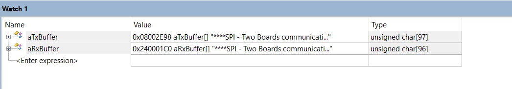

Can you confirm that Rx buffers on slave and on master are both filled with Tx buffer ?
Sometimes I can send the whole frame, but I never have anything in Rx buffer except 0.
March 14, 2018
Posted on March 14, 2018 at 13:24
Yes I can confirm this, the Rx Buffers are both full.
You can check it also on the LED status of the Nucleos (the green and blue LED must be on).
