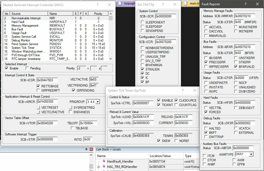

For the registers, here all the informations I can gather from Keil:
I will continue debugging and checking things in the meanwhile.
Thanks for the quick answer!
simosilva
simosilvaAuthor
Senior
Sep 9, 2021 9:34 AM UTC
SCB -> HSFR -> FORCED = 1
BFSR -> PRECISERR = 1
BFSR -> BFARVALID =1
BFAR = 0x00070210, pointing to the Reserved area 0x0001000 - 0x07FFFFFF

update: Still blocked on this Hard Fault.
Checking registers, the fault is Bus Fault, PRECISERR=1, from the application note "the PC value stacked for the exception return points to the instruction that caused the fault."
BFARVALID =1 and the address stored in BFAR is 0x00070210.

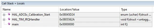

In debug mode, I see a strange behaviour.
0x080454E2 BDF8 POP {r3-r7,pc}
The POP is executed as last operation of the "HAL_ADCEx_Calibration_Start", here is the local stack:
The code fault stay in a POP instruction, the POP is executed when the SP is empty, and this result in turning r4 (the register who is in charge to hold the address of the timer7 in this case) to 0xE000ED14, and then the timer handler is called with the wrong address, the HardFault occurs!
Tryed adding more instruction on the Boot part to disable all the peripherals ongoing, all of these have been found in different forums and threads about custom bootloader jump, none of them seem to solve the issue
For this reason, i think I't something just in the Application side.

simosilva
simosilvaAuthor
Senior
Sep 15, 2021 8:13 AM UTC
Thanks for the reply @Artem.Moroz​ !
I see, anyway digging in my debugger, the program enter in the TIM3_IRQ_Handler, without having enabled the corresponding timer in the application nor into the bootloader, so just uninitializing the peripherals or not initializing them at all (also tried as you suggested) do not solve my problem.
In the snippet of your code, i see a comment
///Remove MX_FMC_Init(), MX_LTDC_Init(), MX_DMA2D_Init(). MX_QUADSPI_Init();
for removing initializations done by the CubeMX, in my experience but most of based on the suggestion of Seniorer colleagues, is prefereable to deinit such peripherals in the USER CODE sections so that CubeMX will never change any of the changes made also in the case of regenerating the code, but this is just a recommendation :)
simosilva
simosilvaAuthorBest answer
Senior
Sep 16, 2021 9:02 AM UTC
EUREKA!
The problem was in the offset of the VTOR.
Looking to the _Vectors size for the STM32H733. the lenght is 0x2CC, so i have the last idea to try different addressing of the application, and moved it from 0x08040200 to 0x08040400, AND IT WORKED FIRST TRY! (obviously changed accordingly the jump in the boot and all the scatter files).
note: the vector table is charged FROM the specified address, so it has all the needed space in memory to fillupp the complete _Vectors with no problem, and it was on multiple of 0x200 as specified in the manuals, so I was following all the rules written in manuals.
The big issue is that in the ST reference/programming manuals the reserved area is always on 9 bits, not 10!
Into the PM0253, chapter 4.3.4 "The table alignment requirements mean that bits [8:0] of the table offset are always zero." so multiple of 0x200! not 0x400!
@Community member​ maybe you know some good ST employee to tag here to correct this precious info?
I surfed so many different blogs and forum searching the solution, but no-one have the same issue simply because tipically the application starts in addresses like 0x08###000 with last 3 words at 0, so this issue just did't appear...
