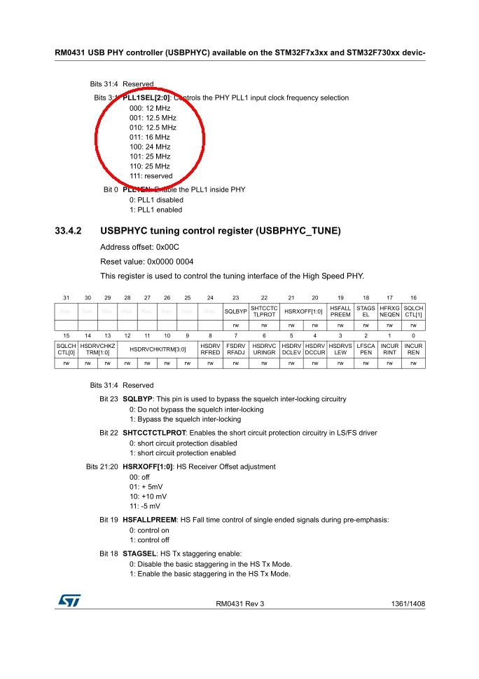

> certain HSE frequencies, which are 12, 12.5, 16, 24, 25 and 32MHz
Are you sure with the 32MHz?
> Apparently this is not documented anywhere.
0693W00000QMX94QAH.pngJW

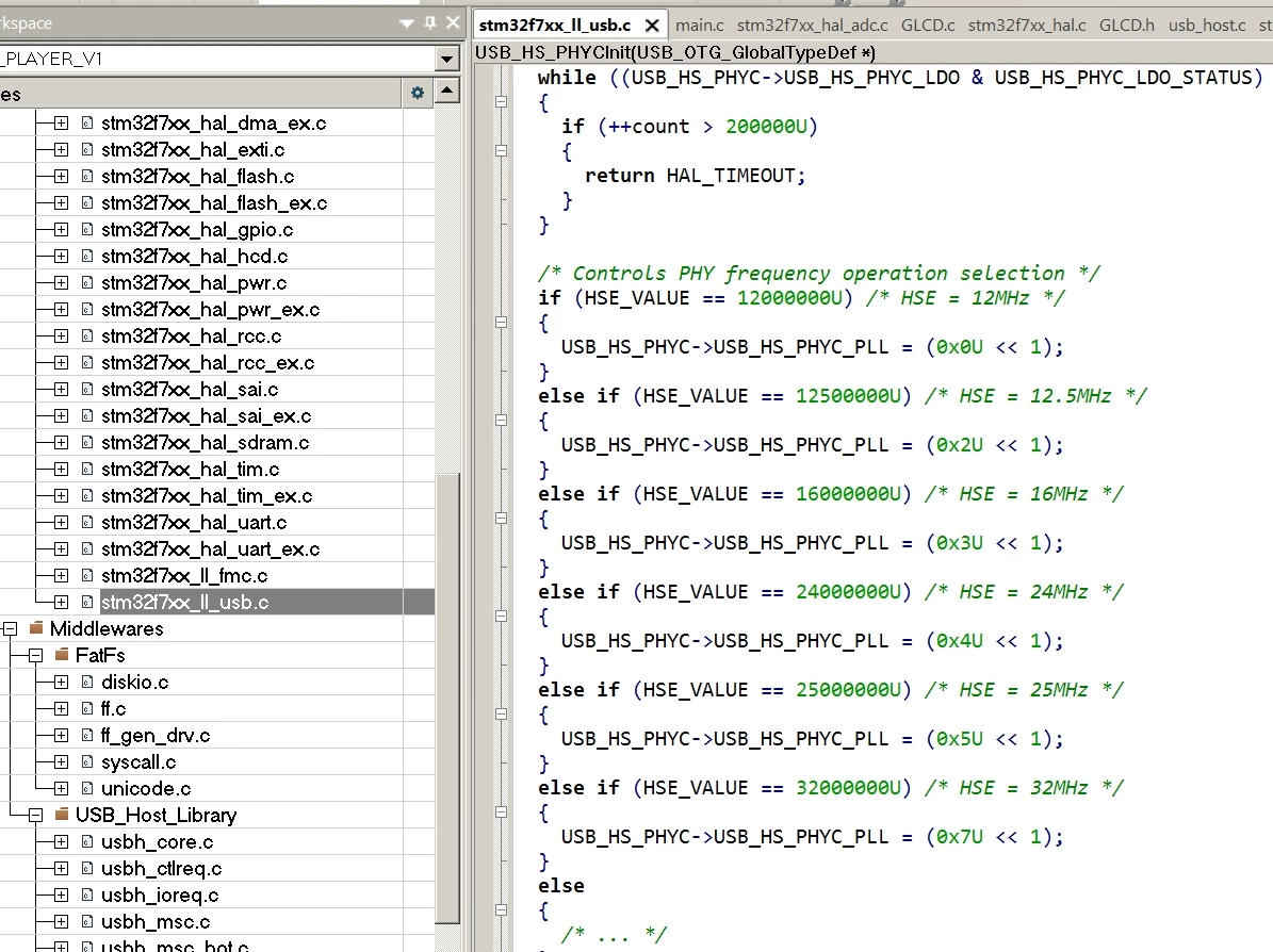

Tokarev.Konstantin
Aug 7, 2022 11:34 PM UTC
Hey there, thanks for the reply!
If we look at the actual stm32f7xx_ll_usb.c file, there is actually a define for a 32MHz HSE. Check this out:
Tokarev.Konstantin
Aug 7, 2022 11:37 PM UTC
I meant that the fact that not all crystal frequencies can be used "out of the box" to get the USB HS working properly, is what is not documented anywhere in a comprehensive manner hehe.
waclawek.jan
Aug 8, 2022 6:15 AM UTC
Hi @Amel NASRI​ ,
Can please this discrepancy between RM and the library be explained?
Thanks,
Jan

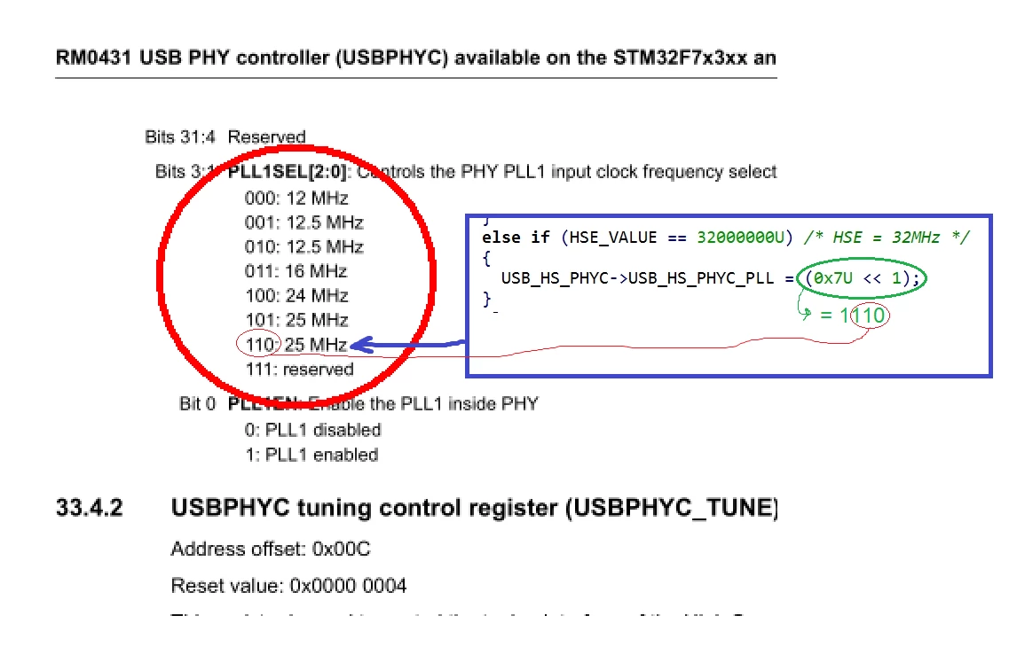

Tokarev.Konstantin
Aug 8, 2022 7:04 AM UTC
I am supposing maybe it is a typo in the reference manual in the PLL1SEL bits selection? Maybe one of the options should be marked as "32 MHz"? The "110: 25MHz", maybe needs to say "110: 32 Mhz" instead?
I do not have a 32MHz crystal to confirm if it would work.
