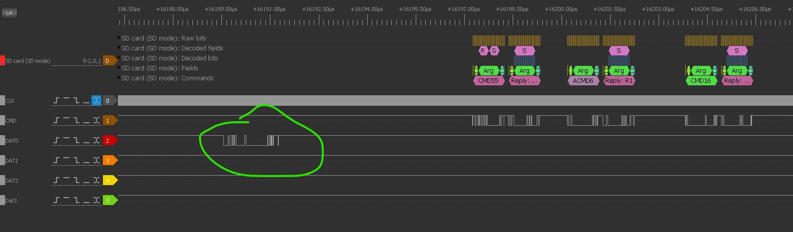

I have a strange issue. I used the SDIO Interface on a F2 and a F429 without issues. But on the first usage with the F446 i run into a strange problem.
With the Logic Analyzer i am observing the communication.

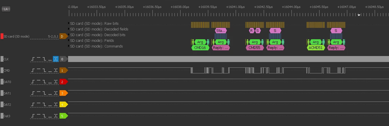

Card Init:
Requesting Card Type, CSD and CID works well over the CLK and CMD Line.
While Switching to the 4Bit Mode i'm getting wrong feedback via the Data line. In detail there is a problem with the FindSCR function still in 1Bit Mode. SDMMC_CmdSendSCR is send out correctly. The DPSM is reacting correct to the Data0 lines response. Flags a set correct for 2 32Bit words but SDIO_ReadFIFO() will only give zero as feedback.

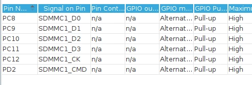

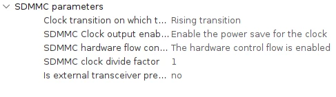

i had similar problems ... now running fine. just some to try:
i set sdmmc clk to 100MHz. + div 1 :
0693W00000Uoa23QAB.pngand meduim or high speed on gpio: (to reduce reflections)
