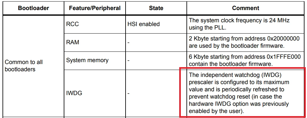

Do you mean the IWDG? I don't enable it in my code.
Or is there another watchdog that is activated for the bootloader and is not disabled automatically?
In the doc I see the following
But your code isn't starting the device is it? If you inherit the watchdog, you're going to have to keep kicking it otherwise the CPU will restart and reenter the ROM based on the BOOT0 pin state.
>>..and is not disabled automatically?
As I understand the functionality you specifically CAN'T disable it
Make sure you get SCB->VTOR set early in your code, the ROM is mapped at zero, the default for SCB->VTOR is zero, and you want it pointing at FLASH at 0x08000000

Thanks a lot @Community member​ !
Fixed by enabling the USER_VECT_TAB_ADDRESS that forces initialization of SCB->VTOR with the base FLASH address in SystemInit() function.
