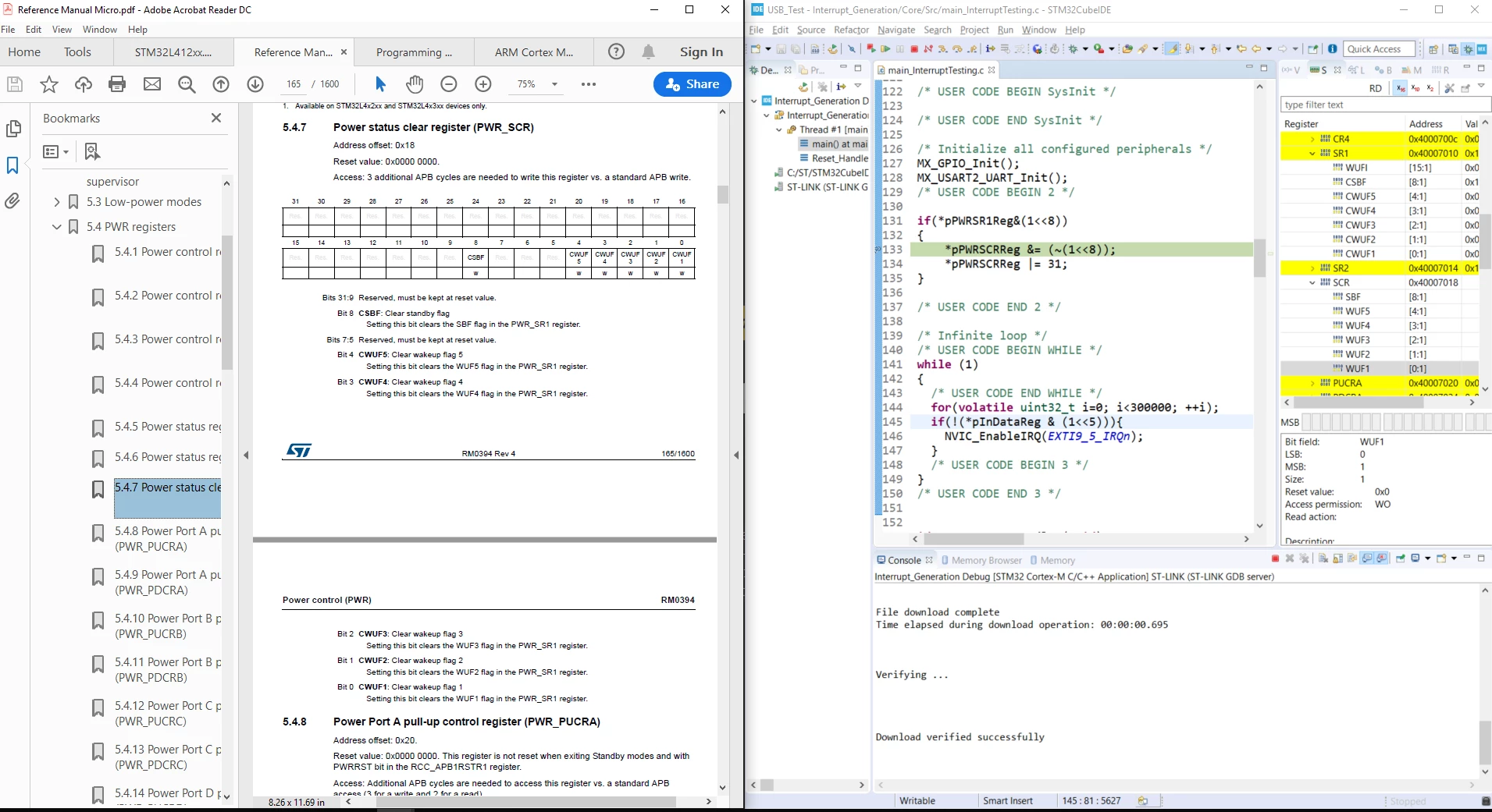

Software Bug I believe. Wrong register contents.

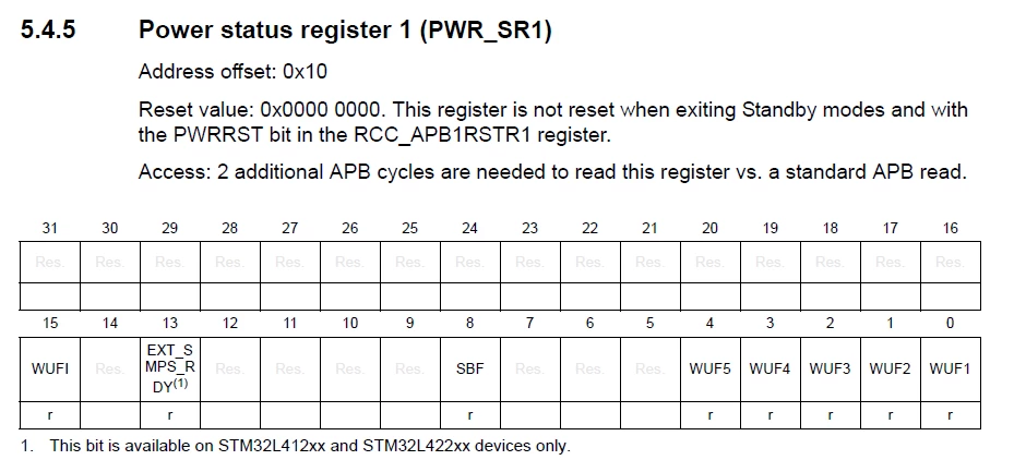

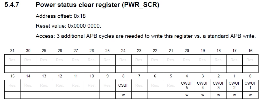

I am using Nucleo - L412KB I think I might have encountered a Software bug. As you can see in the screenshot, the contents of the PWR_SCR in the SW don't match with the one in the reference manual. The contents of this register are probably swapped with PWR_SCR register and some bits are missing too.
PWR_SCR: Power Status Clear Register
PWR_SR1: Power Status Register

The bit naming in SVD file is wrong and ETX_SMPS_RDY bit is missing.

@Piranha​  @HPham.1590​  I am able to successfully do what I have to. It's just the naming. The naming is wrong and yes, I haven't checked the ETX_SMPS_RDY  but, I am sure it works too. Just follow the datasheet, ignore what it says in the Software and you will be able to get your desired outcome.
