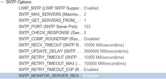

1: IOC file setup (within LWIP setup)
following is custom code written to test sntp setup:

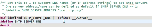

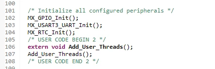

to run this code created a new file and added to main.c as

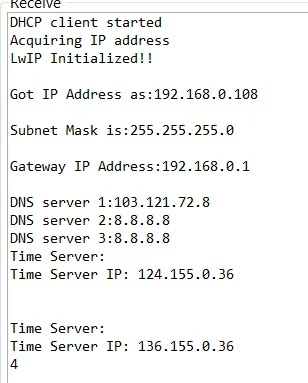

But when I debug i dint get correct  SNTP server address.
I triend both ip and dns method.
checked for dns setting of sntp

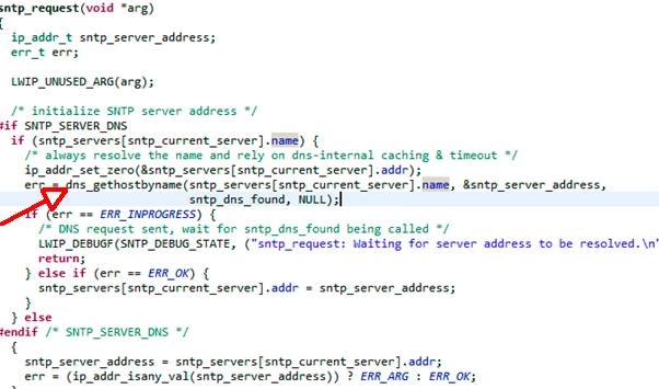

I may be getting error in sntp.c file of lwip in line
Any help please.
Thank you in advance!
Pavel A.
November 11, 2023
Which error do you see there? ERR_INPROGRESS or other?
User431Author
November 13, 2023
the dns query is unable to find correct ip.
also the direct ip method without dns is also not working. as sntp server is set to random value.
