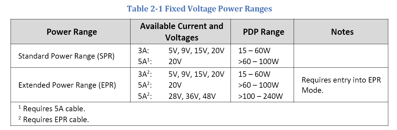

Ok, I understand your question now. In fact, 12V is out of spec. See this extract from PD 3.1 spec:
That is why you cant select 12V from CubeMX. But anyway you can still put 12V in the usbpd_pdo_defs.h file "by hand" if you want, it will not be in line with the spec, but I will most likely work.

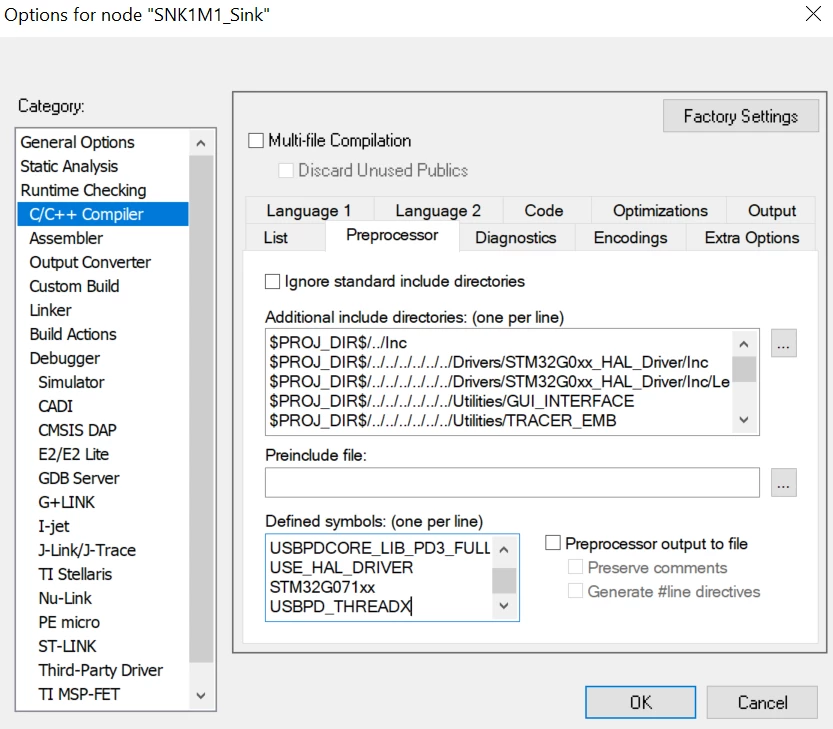

Hi @ABasi.2
Unfortunately, we don't provide direct example for your case!
Did you check USBPD_THREADX symbol to enable in ThreadX support for CubeMonitor API?
To give better visibility on the answered topics, please click on "Best answer" on the reply which solved your issue or answered your question.Best regards,FBL

Nov 6, 2024 2:04 PM UTC
Hi @ABasi.2
USBPD_THREADX can be added as predefined symbol to be used by Cube Monitor UCPD to integrate code that is specific to the ThreadX. Then, using _TRACE and _GUI_INTERFACE, traces in UCPD monitor can be accessed.

i have searched the
USBPD_DPM_TimerCounter()
is defined in usbpd_dpm_core.h but is never called in the code!
where have to be called?
 it is supposed to be called frome "cubemx code" or by the user?
also can you clarify to me where is the  USBPD_THREADX symbol enabled? i didn't recognize the page posted by FBL
thank you!
