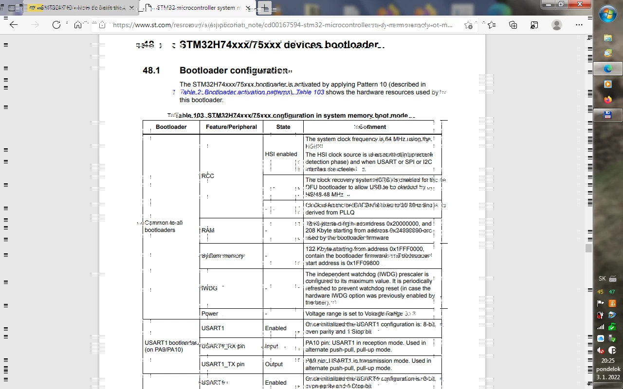

MM..1
Chief III
January 3, 2022
Every MCU have own start addr and you use bad
0693W00000HqRWLQA3.pngstart address is 0x1FF09800
January 3, 2022
> Can you provide an example of jumping directly to the bootloader?
https://community.st.com/s/article/STM32H7-bootloader-jump-from-application
> I posted my code attempt at doing this above and it results in a Hard Fault every time.
So debug the hard fault. Find out what it's objecting to and go from there.

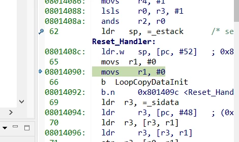

JMill.1
JMill.1Author
January 3, 2022
Thanks for the link. That worked to get my program to jump directly to the bootloader. But now I send the GO command and I'm still in the bootloader. I am trying to jump to 0x0801408c per the disassembly, but nothing happens. I confirmed that the GO command is being ACK'd.
EDIT - It seems like the debugger was messing with the operation somehow. When I program and disconnect before invoking the bootloader, then jump to this reset address, everything works fine. Thanks for the help!
