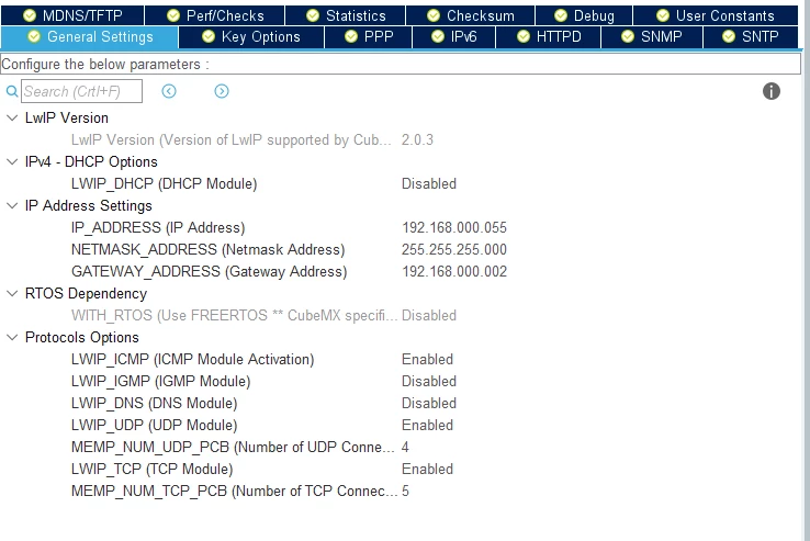

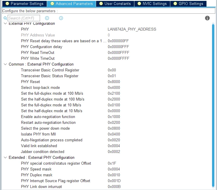

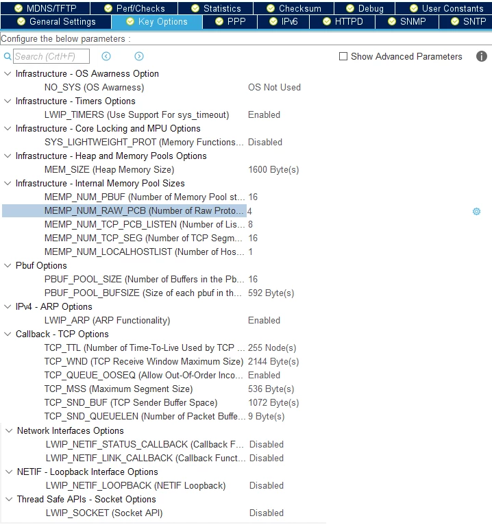

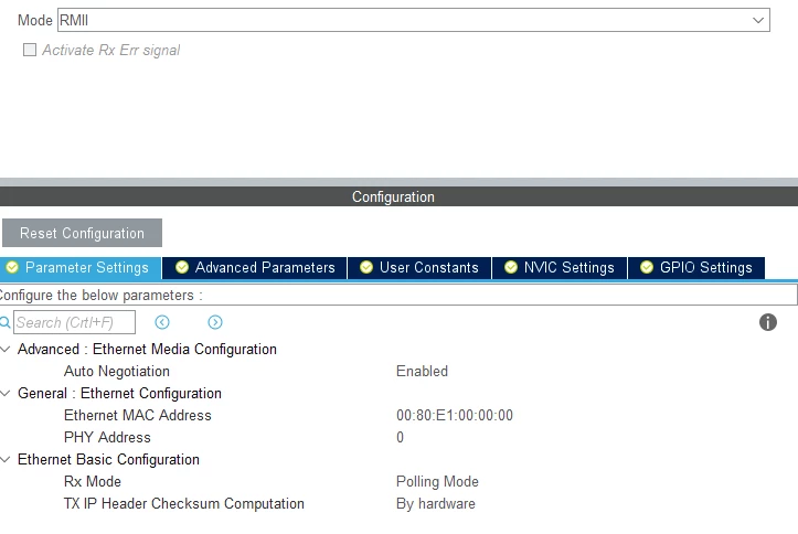

Ok, so I have found the best simple explanation on this under this link:
https://github.com/martinbrickey/lwip/blob/master/STM32%20Ethernet%20Start%20Point%2020180307.pdf
This seems also not to work for me, because I'm not able to get a response to a ping.
To make the picture more clear, I have disabled the HTTPD, so the topic about the fsdata.c is not important at this time. The goal is just to ping the HW and get a response.
Here are my settings for the ETH:
0693W000004KAMcQAO.png0693W000004KJFBQA4.pngAnd for the LwIP:
Here is my main.c code:

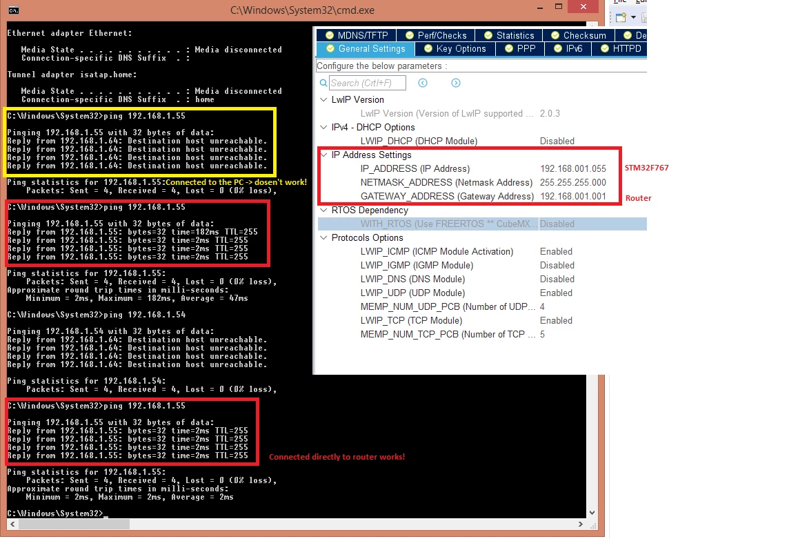

I will just continue this self-discussion :)
After some try's with my router I was able to ping my F767 Board, but only when it's cable connected to the router. The ping was sended from my PC connected to the same network as the router.
Here a picture of the ping details:
The question is: How can I ping the F767 Board when is directly connected to my PC and not to the router (with which settings) ?
Regards,
Gregor
