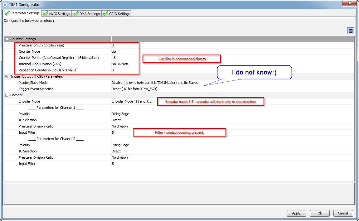

I'm using TIM5 for quadrature encoder counter. Following you suggestion to configure the timer, I have question with reference to capture below. Since the encoder channel A and B are mapped to TI1 and TI2 and the encoder Mode is TI12, and the counter is counting on both rising and falling edges of TI1 and TI2 inputs.
Question: Why selecting Rising Edge instead of Both Edge in the polarity selection? (In fact the chip User Manual says 'This configuration (Both edge) must not be used for encoder.' and I don't understand why not?)
Anyone know why the polarity must be set to Rising Edge (instead of Both edge)?
Best,
Brian

I don't Cube so I don't know what exactly is meant by 'Both edge', but if it's setting of  TIMx_CCER.CC1P (which you've read) then it's because that is a setting for the 'edge detector circuit', in the channel input, which in encoder mode (and a few other modes named therein) does not work as an edge detector but as a selectable invertor, thus has only two settings (and the 'both edges' is the third). The encoder decoding circuit in the slave module does take levels from the input channels (TI1FP1 and TI2FP2 signals, see TIM block schematics) rather than edges - it then detects the edges in itself.

In other words the CubeMX is wrong under its Parameter Setting\Encoder\Polarity to have the selection of Rising Edge, Falling Edge, Both Edges. Because in encoder mode, regardless of TI1 Mode, TI2 Mode, or both TI1 and TI2 Mode, the counter should be triggered on both edges of each channel; it is not a choice. Therefore, the wording should be Inverted or non-inverted under Polarity selection.

Yes, but that's only in encoder mode (and a few other modes), so those settings interact, that makes programming CubeMX far less trivial than only directly mapping  few register bits to some single-liners.

I'm a newbie to STM32 tool sets and so I found Cube is helpful in understanding how the registers are acessed, and a quick way to see generated codes that initializes the registers -- in a strict sequential order sometime -- for the peripherals to work properly. I total agree about reading the registers and their bits meaning. In fact I write my own code since the Cube generated code is too long; i.e. Cube uses over 50 lines of C code to send SPI data, while I need only two lines of code:
while((SPI2->SR)& 0x0080); // if busy
SPI2->DR=0x0A; // TX data 0x0A to Canon EF lens.
As about the Cube wording, there is nothing wrong about using a proper wording when the timer is in Encoder  Mode. The GUI screen should be adapted to each mode of the timer usage. Why the encoder mode has to share the same description with other modes?
