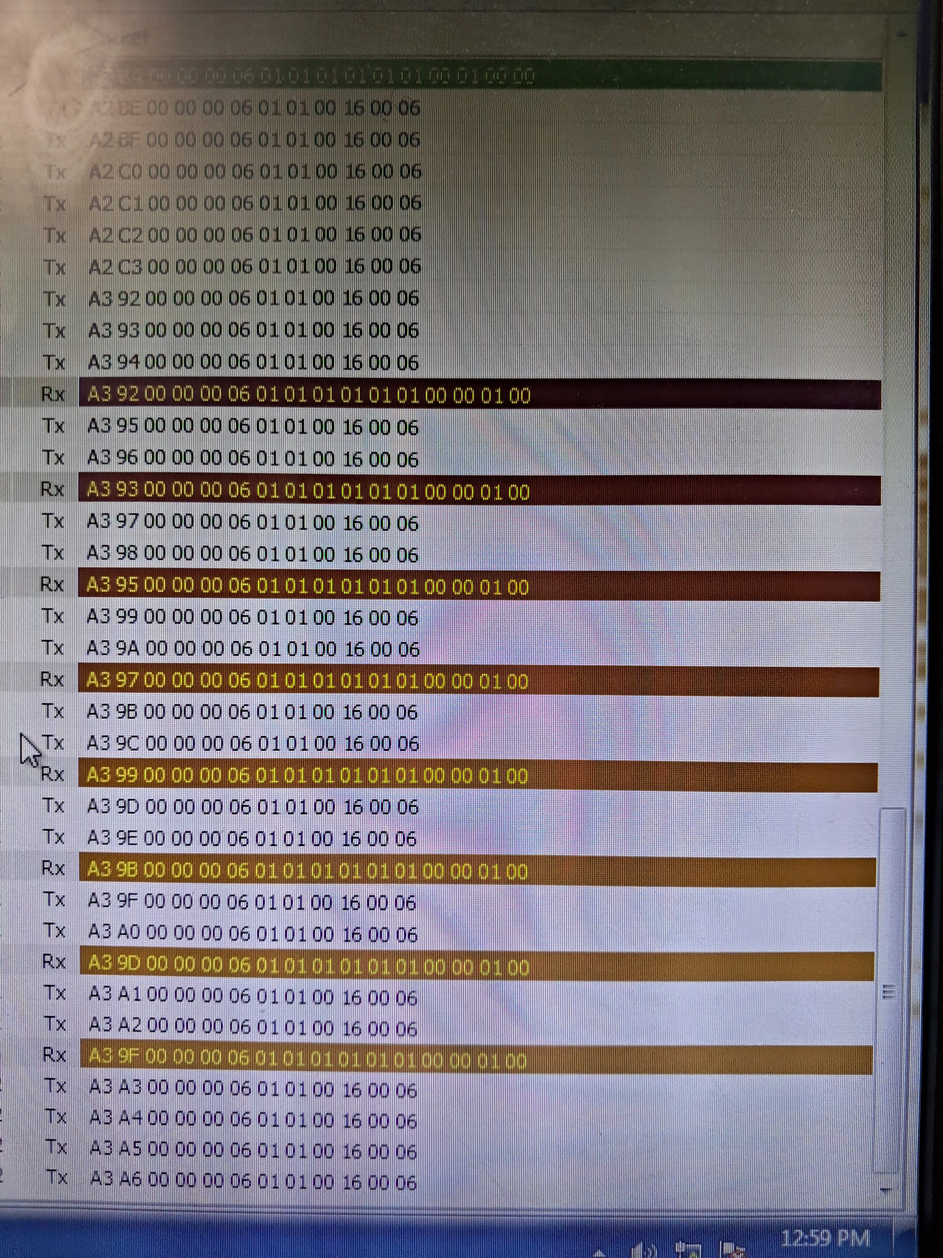

Let me make the observation more clear:
When I connect the ModScan32 tool to the Modbus server on the Board, the very first request will be answered correctly in a Modbus response packet. The tool continues to send the requests, which are not answered. Since this Modbus server is based on the TCP Raw Socket Echo server, it simply echoes the request data in the response packet for the 2nd request onwards. Hope this helps.

I have implemented the suggested code change. Now I'm getting more number of responses, around 8-12. After that, the server-client connection is breaking. The server continues to run, but there is no ping response and Modbus response from the Board.

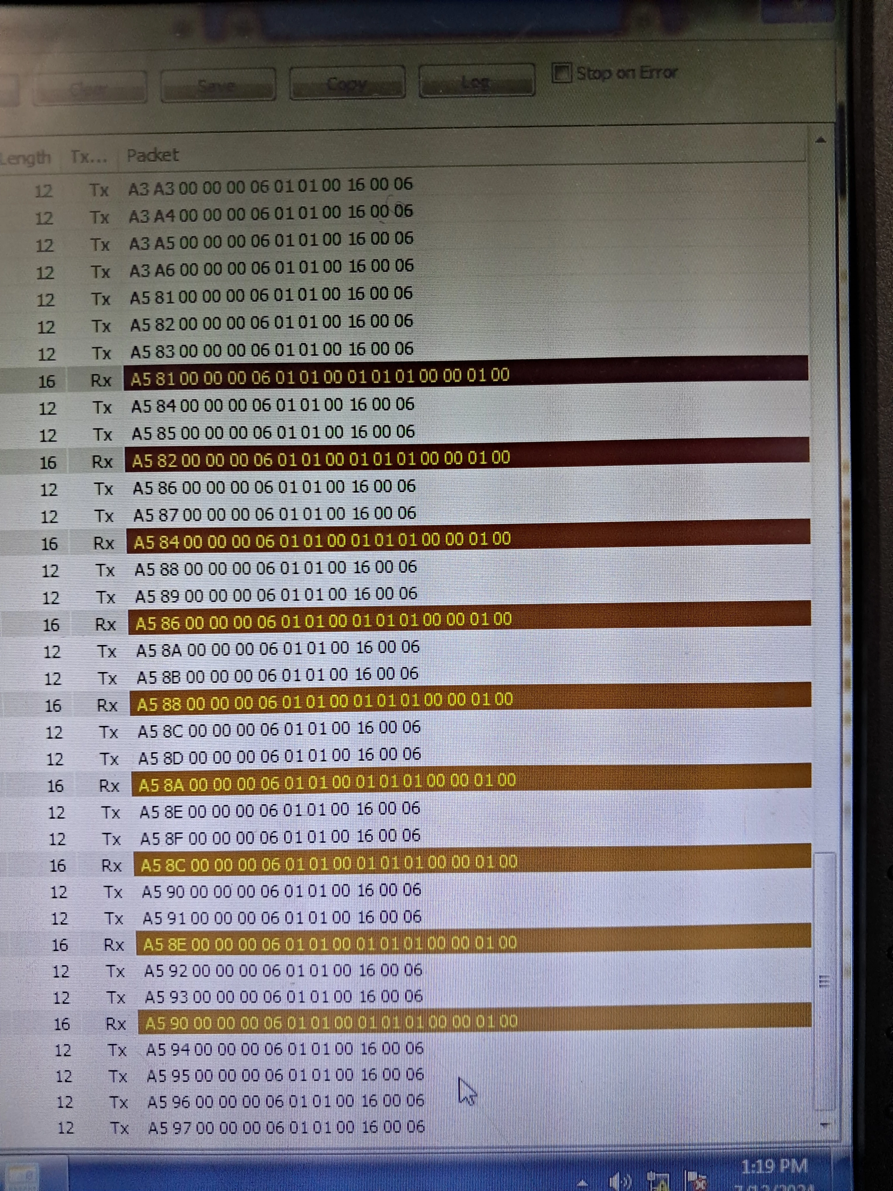

Today's observations: The ModPoll tool continuously sends the configured Modbus requests. With the suggested source code changes, the expected Modbus response is sent for the first 9 requests. I've repeated and confirmed that this is the case. Why is it 9? After 9 responses, it is falling back to echo server mode. I can see the logic in the suggested code changes, and I think it should work. Or maybe the state changes have to be managed more suitably? Or a different Server altogether need to be installed? My initial understanding was that by properly setting the Response, it should be possible to change it to a standard server. I did this attempt, as I couldn't find a better option. I need help in this regard. Many thanks in advance.

Thanks for the suggestion. I've created a packet buffer in ModbusIxFace(struct pbuf *p), using pbuf_alloc(). I've freed it in tcp_echoserver_recv(..), using pbuf_free(), where:
es->state == ES_CLOSING
But now the server is responding 4-5 times only and then stopping responses. The file is attached. Please check and suggest. I've tried the same at other locations also, where pbuf_free(p) was called and where: es->state = ES_CLOSING_SERVER;
In the program, I've created only one packet buffer, and tried to free it. But it doesn't seem to improve - hardly 4-5 responses.
