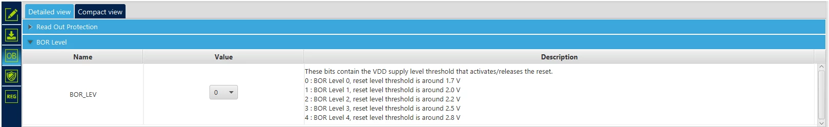

Hello ​@杜明恢
Add to what ​@Saket_Om said, I should mention that you can modify BOR level using STM32CubeProgrammer
just connect the product and select the wanted BOR level
looks like an easier way
BR
Gyessine
