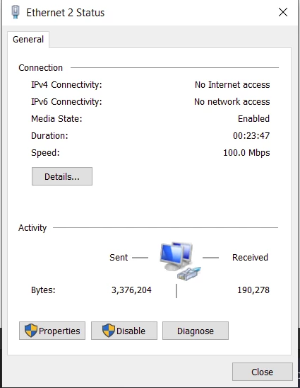

Hi
Im trying to set the speed for ethernet to 10Mbps, using
HAL_ETH_SetMACConfig()

This does not seem to set the speed to 10Mbps.
Is there anything I'm missing?

Hi
Thanks for the reply. Why should the NIC on the PC be set to 10Mbps? Shouldn't the device auto negotiate by itself to 10Mbps after MACConfig is set? Maybe I'm wrong but wouldn't this situation work:
Ethernet NIC on PC (Auto Negotiate) <-> STM32H5 (10Mbps full duplex)
Shouldn't this cause the NIC to set speed automatically as 10Mbps instead of manually setting it in the NIC ?

I think you must tell the PHY to turn off auto-negotiation and set it to 10 / FD (and the STM32 MAC).
Check the PHY datasheet, I think auto-negotiation is on by default.

Hi
The component responsible for the link speed is the external PHY (LAN8742 on most ST boards).
The STM32 Ethernet MAC is just configured afterwards, depending from what speed was selected in the PHY.
It seems that by default the LAN8742 is configured for auto negotiation.
I guess if you want to force a specific speed you could configure the PHY to disable auto negotiation and select 10Mbps. Using BSP component functions LAN8742_SetLinkState().
Oct 9, 2024 10:23 AM UTC
I found nx_eth_phy_set_link_state()  which sets the speed. But not sure where to call it from. Calling it in _nx_driver_enable() sets the link down for some reason. Is there no way to set this in CubeMX ?

Oct 9, 2024 12:33 PM UTC
I was able to get the speed to 10Mbps by modifying
static VOID _nx_driver_enable(NX_IP_DRIVER *driver_req_ptr) in nx_stm32_eth_driver.c
if (nx_eth_phy_init() != ETH_PHY_STATUS_OK)
 driver_req_ptr -> nx_ip_driver_status = NX_DRIVER_ERROR;
 return;
 // set to 10 mbps
 if (nx_eth_phy_set_link_state(LAN8742_STATUS_10MBITS_FULLDUPLEX) !=
 LAN8742_STATUS_OK) {
 return;
 // wait till link is up
 while (nx_eth_phy_get_link_state() <= ETH_PHY_STATUS_LINK_DOWN) {
 // get state to check
 PHYLinkState = nx_eth_phy_get_link_state();
Is this the best way to do this? Is the ethernet driver supposed to be modified by others?

Hello @LCE & @jishnu1234 ,
the nx_stm32_eth_driver.c is not part of The HAL cube environment but is a port specific file for Netxduo and it is based on a generic template that can be modified according to the needs so no problems with Updates on this side.
Regards
