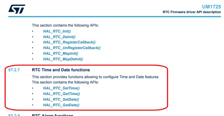

Hello everyone, i am working on a software for setting the date and time.
The plan is to set the date and tame manually (so no defficulties regarding that) and then continue to increase within the time flies thanks to the RTC of the NUCLEO F401RE.
Do you think that would be possible ? Would it be a simple way to set the date and time, by directly using the RTC with HAL libraries for example ?
Im thanking you already for your answers,
XOXO

May 14, 2024 1:21 PM UTC
CubeF4 firmware package:
https://www.st.com/en/embedded-software/stm32cubef4.html
On the 'Documentation' tab:
https://www.st.com/en/embedded-software/stm32cubef4.html#documentation
UM1730 Getting started with STM32CubeF4 for STM32F4 series MCUs;
UM1725 Description of STM32F4 HAL and low-layer drivers;
AN4739 STM32Cube firmware examples for STM32F4 Series
 The HAL gives you functions to set the RTC Time & Date:

RomainR.
May 14, 2024 1:00 PM UTC
Hello @willow
I suggest you to refer to the following example, it should works on Nucleo-F401RE.
STM32Cube_FW_F4_V1.28.0\Projects\STM32F410xx-Nucleo\Examples\RTC\RTC_Calendar
Best regards,
