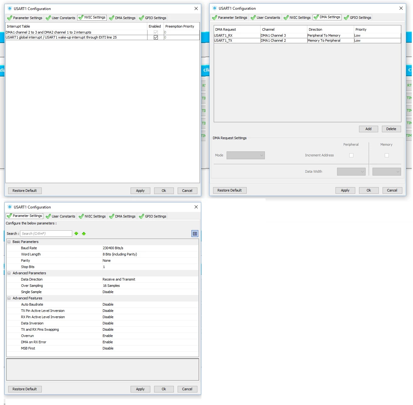

I use this to transmit by DMA, but the code should show you what you need to know;
    if (TxDMA1BufHasData) {
        char uartState = HAL_UART_GetState(&huart1);
        if ((uartState == HAL_UART_STATE_READY) || (uartState == HAL_UART_STATE_BUSY_RX)) {
            TxDMA1BufHasData = false;        // sending now
            if(HAL_UART_Transmit_DMA(&huart1, (uint8_t *)Usart1TxDMABuffer + U1TxBufferPtrOUT, U1TxBufferPtrIN - U1TxBufferPtrOUT) == HAL_OK) {
                U1TxBufferPtrOUT = U1TxBufferPtrIN;
                Usart1TxDMABuffer[U1TxBufferPtrIN] = 0 ;    // null not needed
            else {
                _Error_Handler(__FILE__, __LINE__); /* Transfer error in transmission process */

T J
Senior III
January 30, 2018
Posted on January 30, 2018 at 06:53
it doesnt look like you need DMA, its all I have to offer..
Thats the runtime use of the code that works for me, other than that I have the same init code from the cube.
but how did you initialise the port inside the cube ?
To make it work like this, you need to configure the Usart to use the DMA, inside the cube.
