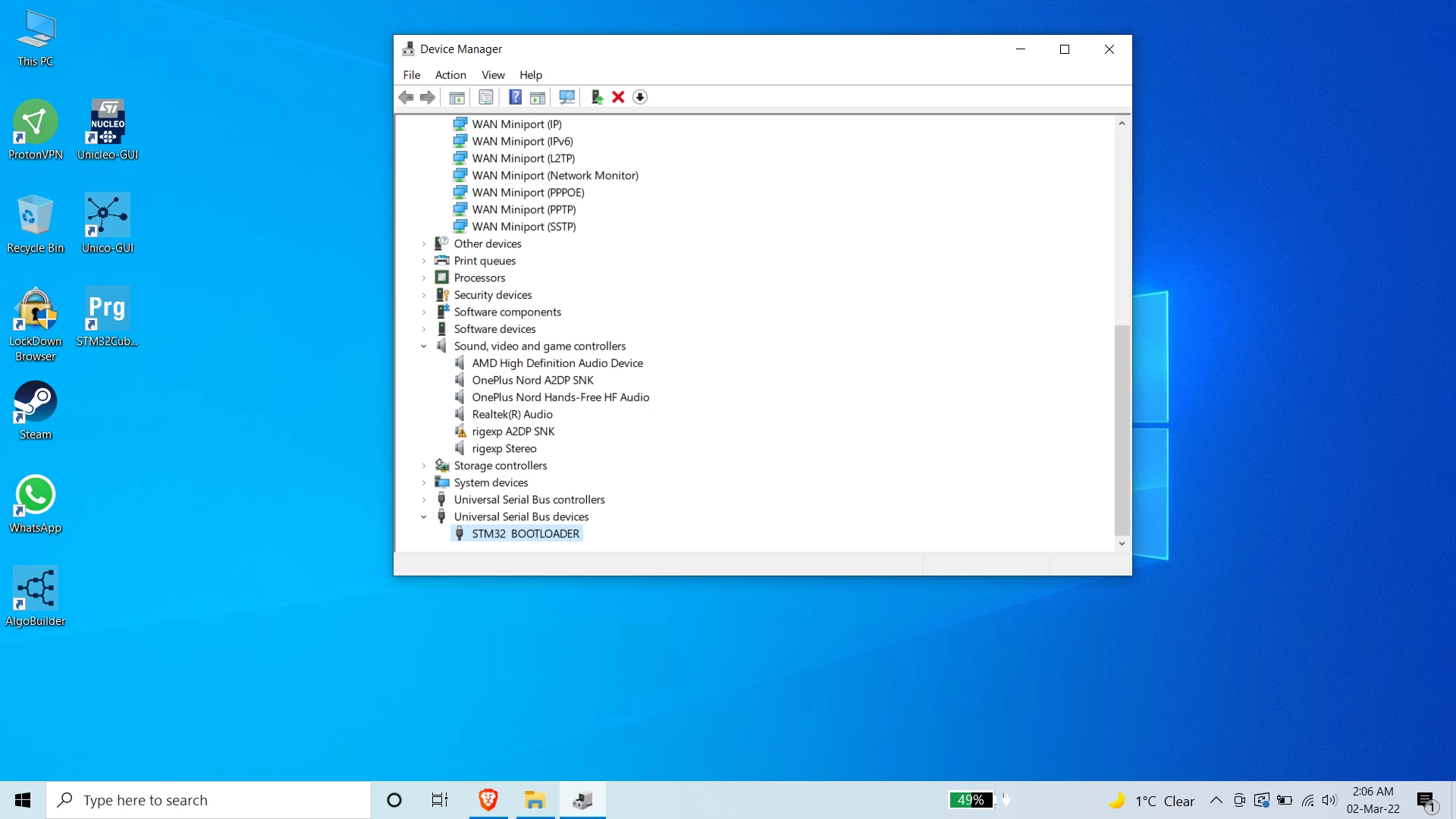

Sensor Tile Box does not go to DFU mode from Bootloader mode. How can the DFU mode be obtained again?
After uploading the BLEFOTA.dfu file using Dfuse Demo utility, the SensorTileBox is not going into DFU mode anymore. Instead it shows that STM32 is in BOOTLOADER mode as shown in picture. Now, I cannot seem to plug it into DFU mode, the one by disconnecting the battery, pressing the boot button and then inserting the micro USB cable.
How can I make the SensorTileBox go into DFU mode again from the current Bootloader mode?
I basically need the COM port detection, meaning STM32CubeProgrammer or Unico will be able to detect the device via COM port. When I initially plug the USB device from my laptop to SensorTileBox in a general way (like with battery connected), no COM port was detected, but instead it shows "USB Drive (G:)" instead on COM port detection on my Device Manager.
