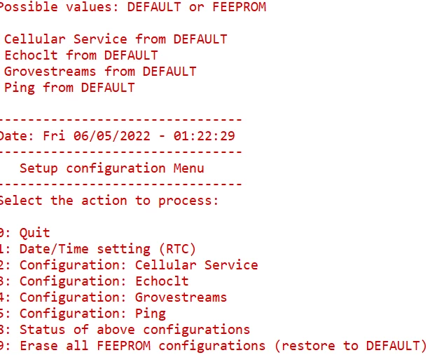

Hey Almer, really interested to try this as well but looks like there is no support from ST. I think you could try downloading X-Cube-Cellular v5.2 instead.
Link: X-CUBE-CELLULAR - Cellular software expansion for STM32Cube - STMicroelectronics
Inside there is a HTTP project application that shows a client connection to Grovestream.
