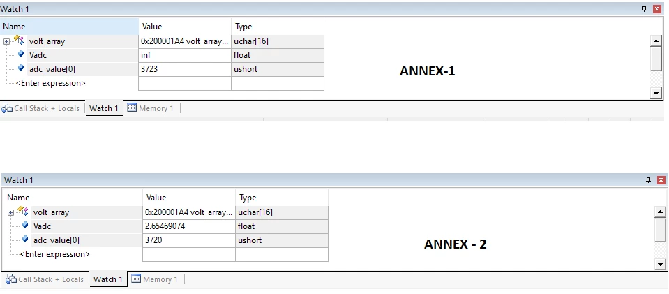

Hello there,
Thank you for your answer. When I watch the Vadc value as below, the value is read infinitely. (You can see in the first picture in the Annex-1.)
while (1)
Read_ADC();
sprintf(volt_array, "%.4f\n\r", Vadc);
CDC_Transmit_HS((uint8_t*)volt_array, strlen(volt_array));
Vadc value can be read if I don't use the sprintf function. So if I call in the following way, Vadc value can be read. (You can see the second picture in the Annex-2.)
 while (1)
Read_ADC();
//sprintf(volt_array, "%.4f\n\r", Vadc);
April 24, 2020
On the first call, adc_value[1] = 0, thus
Vdda = (float) 3.3 * (*VREFIN_CAL) / adc_value[1];
is infinity. Thus,
Vadc = Vdda * adc_value[0] / 4095;
is infinity as well.
It looks like you're trying to convert two channels with the same ADC in the same conversion group. This requires DMA to handle effectively. Otherwise, the values will overwrite one another since they share the same output register ADC->DR. What you're trying can work, but only if your CPU is fast enough to handle every single interrupt and if your conversion rate is slow enough.
From the reference manual:
13.8.1 Using the DMA
Since converted regular channel values are stored into a unique data register, it is useful to
use DMA for conversion of more than one regular channel. This avoids the loss of the data
already stored in the ADC_DR register.
