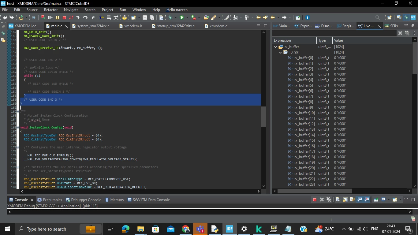

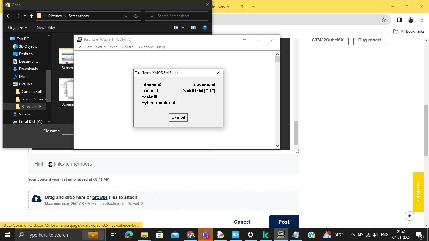

send a file from tera term pro(XMODEM-CRC) and received it in stm32f429zi board
i try to send a .txt file(1KB) from tera term pro(transfer>xmodem>send>select file with CRC)  and i want to received the file on stm32f429zi controller. but , tera term monitor was blank and i check with stm-side also in live expression but no values received ....i will attach the and photos. please check

Expect as a developer that you're going to need to debug your own code. Understand the anticipated interactions.
Random screen shots and code fragments aren't going to do it.
Your STM32 side code is going to need to send some initiating bytes to indicate it is ready for data reception.
For X-MODEM-1K this would be 'C' characters. Perhaps once a second until data starts flowing.
The protocol is over 3 decades old, I'd expect there to be working examples out their, and it's always be sufficiently well document to implement from scratch.
Jan 8, 2024 5:25 AM UTC
i can't find the exact examples
