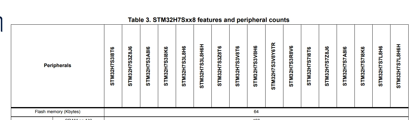

Need to look at your linker file and the map file. Knowing that STM32H7S3 device has 64KB of internal Flash:
But "estimated minimum size" doesn't make sense. It could throw a message in the sense of you've exceeded the memory but "estimated minimum size" is something weird/new to me.. may be you truncated the message?
Are you using an external memory?
You need to provide more details and give the complete error message.

Mar 14, 2025 8:15 AM UTC
The System flash is from 0x1FF0 0000 to 0x1FF1 FFFF described on the page 151 of RM0477 Rev 8 manual.

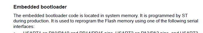

mƎALLEm
Mar 14, 2025 8:29 AM UTC
This is the bootloader. You don't have the access to program it:
The only access you have is the user Flash: 0x0800 0000 - 0x0800 FFFF
