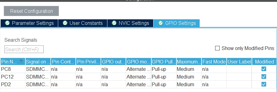

Set for beginning: 1bit mode, pin speed medium + pullup ON , on all lines.
Then try again.

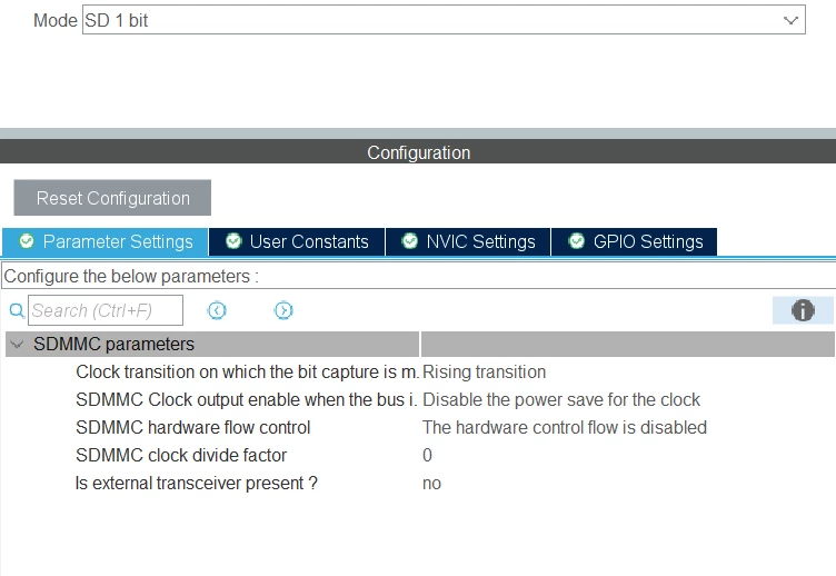

April 2, 2025
I tried your solution but i still have the same error. I put screenshots of the parameters of SDMMC1, i think i'm missing something.
And to answer to your question yes i search SDMMC on the forum, i tried solutions about the delay like i said but nothing works.
AScha.3
April 2, 2025

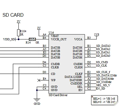

Ok,
next...is the interface voltage setting ok ?
from cpu: PH8 + PH10 :
You dont need to look at card commands , just : init..., then mount(...1); parameter 1 = mount now .
Then try to read directory...if its ok, then sd-card access looking fine.
