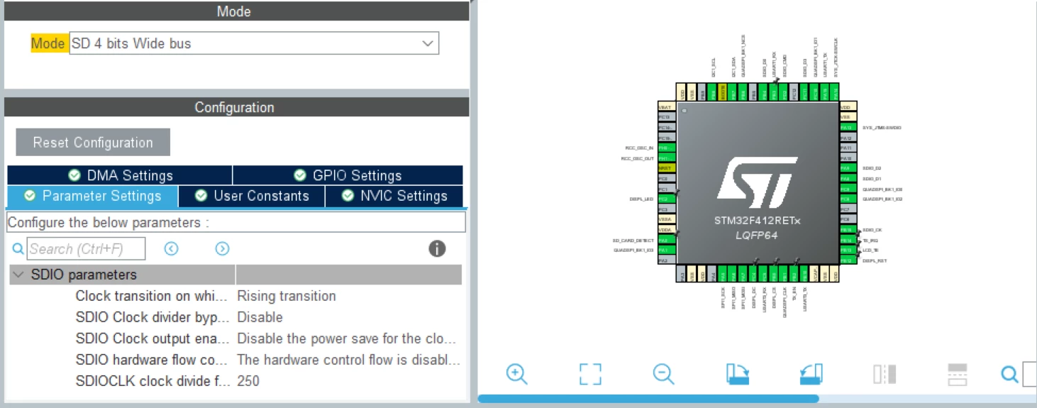

I am trying to get an sd card to work with my custom board, uses STM32F412RET6.
when i try to mount or do anything other than init in 1 bit mode the code gets stuck at this point. I have been able to read block size and number from the SD card but that is it.
 while(!__HAL_SD_GET_FLAG(hsd, SDIO_FLAG_RXOVERR | SDIO_FLAG_DCRCFAIL | SDIO_FLAG_DTIMEOUT))
if(__HAL_SD_GET_FLAG(hsd, SDIO_FLAG_RXDAVL))
*(tempscr + index) = SDIO_ReadFIFO(hsd->Instance);
index++;
else if(!__HAL_SD_GET_FLAG(hsd, SDIO_FLAG_RXACT))
break;
if((HAL_GetTick() - tickstart) >= SDMMC_SWDATATIMEOUT)
return HAL_SD_ERROR_TIMEOUT;

The SDIO peripheral has race conditions where data needs read out quickly enough otherwise it overflows. Use a higher clock prescaler to see if that solves the problem. If it does, the solution would be to use DMA or rewrite code to be faster. Using Release mode can be a bandaid.
drJonesyAuthor
Aug 6, 2026 21:41 UTC
DMA is enabled and prescaler is set to 250

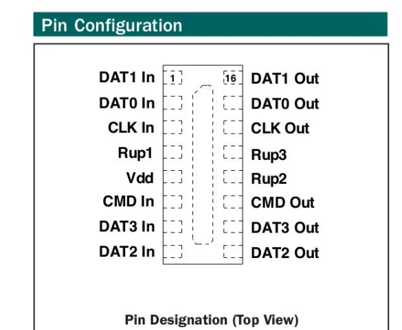

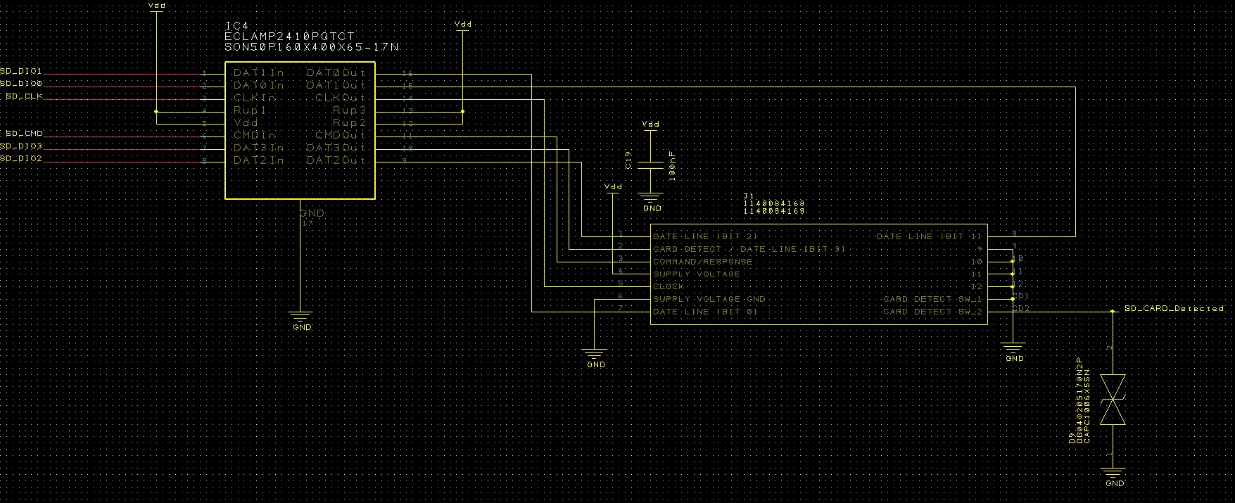

Hi
Thanks for the heads up about what the problem may be. I have set GPIO to medium speed and pull up but that doesn’t help.  I will focus on the circuit design and check for wire lengths.
Just as I started writing this, I checked my circuit, for Errors and low and behold. The problem was on the eclamp pin 16. it is set dat0 in the schematic but Dat1 in data sheet. Very disappointed in myself for not checking.
Thanks for the heads up. I will modify my circuit and see if i get a fix.

Aug 10, 2026 20:16 UTC
Hi All
I am now reading the SD CARD. Problem as above. Thank you AScha.3 for your help with this issue. You can now close this issue.
