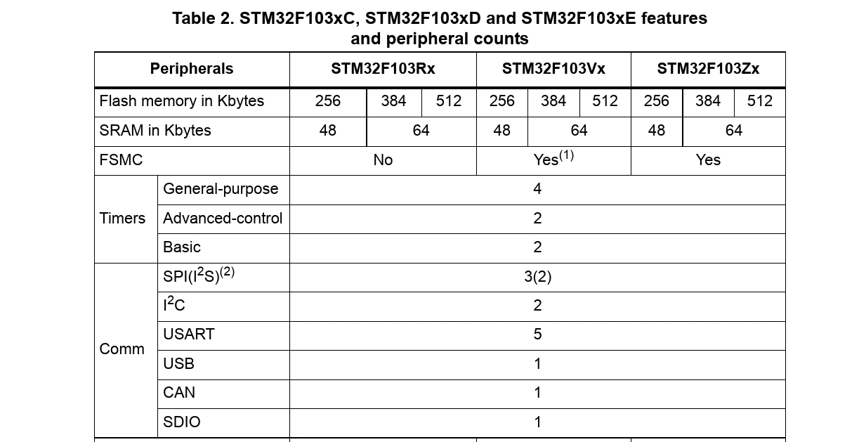

AScha.3
Oct 11, 2022 7:09 PM UTC
the STM32F103 has not SDIO module in most versions. so ??
Tesla DeLorean
Guru
Oct 11, 2022 7:40 PM UTC
Well the product page seems to infer that it does, but like I said been years, and ST has some much better solutions these days.
https://www.st.com/en/microcontrollers-microprocessors/stm32f103rc.html#overview
And definitely members of the F103 family that do, others that don't have enough pins. All could likely support SD Cards via SPI

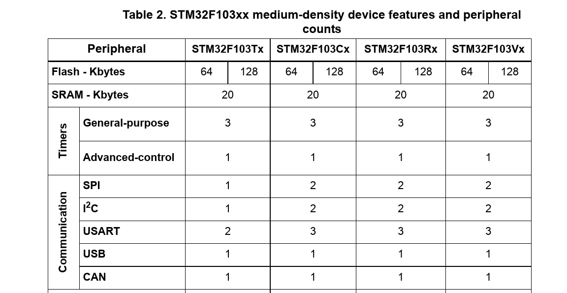

AScha.3
Oct 11, 2022 8:01 PM UTC
ah, ok...high density line >= 256K flash should have it. (never look at this, because F103 is "the old standard" (blue pill) cpu ... F103 medium density - no SDIO. so - is same die , or not ?
0693W00000UnqknQAB.pngbut not here:
