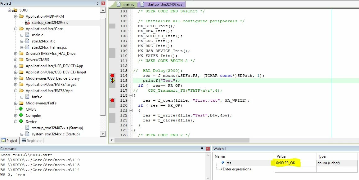

Here is the example code. I added DMA to SDIO and relative paths to FATFS. STACK and HEAP is just big , not studied0693W000006HJwgQAG.jpg

Vangelis Fortounas
Jan 1, 2021 2:02 PM UTC
Hello.

Vangelis Fortounas
Jan 1, 2021 8:03 PM UTC
I ported the code to 32F407VE by changing only the startup file in KEIL MDK (i changed also the device type) Both devices have the same pinout for SDIO)
The result was as expected. The SD 16GB sandisk, 8k cluster formated, mounted with no error.
Maybe is a hardware issue, pinouts, bad soldering, etc0693W000006HJRTQA4.jpg

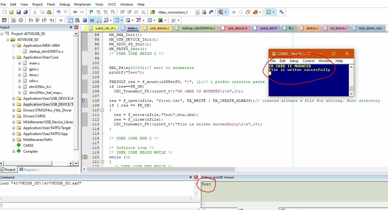

Vangelis Fortounas
Jan 1, 2021 9:10 PM UTC
For some reason the CDC device couldn't enumerated with your code .
I tried with "fresh" produced code from my CubeMX and was OK.
I suggest to solve the problems one by one with special produced code for every issue. Update all cubes and firmwares and check also the errata sheet for possible limitations.

Vangelis Fortounas
Jan 2, 2021 8:28 PM UTC
Hello
I can read an write to 16GB sandisk sd card. (look at the screenshot). FATFS ver=R0.12C Check the format of SD card or reformat it( usualy this solves most problems)
As for the DMA, i forgot to enable the dma version of diskio. But works fin if enabled also.
