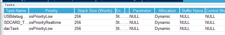

sd card functions throwing Hardfaults() inside tasks but not in main (FREERTOS+SDcard(spi))
I am following this Controlerstech tutorial , learning how to FREERTOS+SD card.
I found out some functions that work fine outside any os task , throw a Hardfault when executerd inside any FREERTOS task.....
Functions that seem to be working from him.
I feel like these functions are trying to access a forbidden area of memory.... but i dont know why is it forbidden, are there any memory boundaries we should respect when working inside tasks?
I am new with FREERTOS and their QA didnt helped me yet.

I fixed it, my Task priority needed to be raised to osPriorityRealTime
