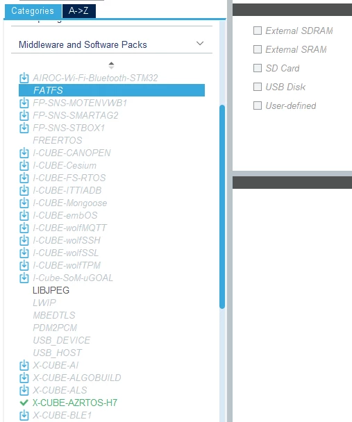

Does anyone know how to link the sdcard_detect gpio pin in cubemx?  If the card is not inserted after power up, the system doesn't come up because  MX_SDMMC1_SD_Init(); fails.
I looked at: https://community.st.com/t5/stm32-mcus-embedded-software/understand-sd-card-detect-pin-initialization/td-p/758978
but I'm using AzRTOS, and I can't set the option in FatFS, and can't find the option in FileX.
Can someone point me in the right direction?

Hi @mƎALLEm
How do you link the SD_detect pin when AzRTOS is enabled?  it seems FATFS is grayed out in my CubeMX
I cant seem to find that option under FileX.
Thanks

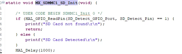

I've added this code to prevent the system from crashing when initializing the SDMMC on powerup.
But is there an example somewhere on how to re-initialized the driver when a card is plugged in, and get AzRtos/FileX to start reading the SDMMC?  Is there anything in a library without having to re-write a basic function?
I looked at these examples, Fx_Dual_instance, and Fx_MultiAccess, but it seems it will only run if the card is plugged in, and i didn't find any code for the card detect pin.  Shouldn't that be part of the base Driver code?
static void MX_SDMMC1_SD_Init(void) {
	/* USER CODE BEGIN SDMMC1_Init 0 */
	if (HAL_GPIO_ReadPin(SD_Detect_GPIO_Port, SD_Detect_Pin) == 1) {
		printf("SD Card not found\r\n");
		return;
	} else {
		printf("SD Card Detected\r\n");
	HAL_Delay(1000);
	/* USER CODE END SDMMC1_Init 0 */

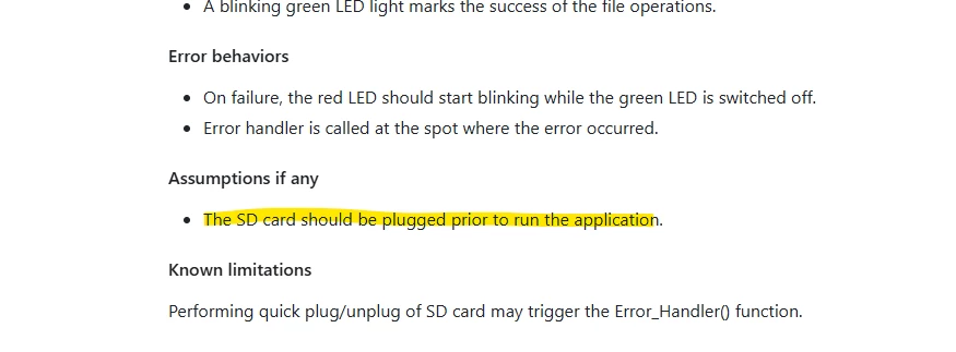

Feb 19, 2025 2:42 PM UTC
Hello @matt-crc
Please refer to the example 'Projects/STM32U575I-EV/Applications/FileX/Fx_uSD_File_Edit' to manage card insertion/removal detection in your application.
In order to give better visibility on the answered topics, please click on 'Best answer' on the reply which solved your issue or answered your question. Saket_Om

Feb 20, 2025 9:15 AM UTC
Hello @matt-crc
You are right!
In this case, you can perform a check to detect the presence of the card before calling the HAL_SD_Init() function.
In the application mentioned above the card should plugged before running the code. Please see the readme.
