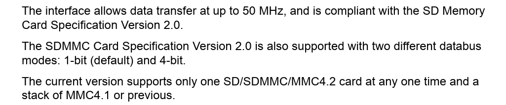

Does SanDisk Secure 4GB Class 4 SDHC Memory Card will support with STM32F732IE if not could you please suggest SD card with all specifications?

The SDMMC interface works with all cards, that are compliant with the SD Memory Card Specification Version 2.0.: (see rm)
I prefer to use SanDisk extreme 32GB (micro SD), ymmv .  (4GB are very old, almost nowhere available now.)
