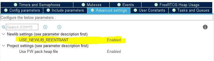

While re generating through Cube MX for MDKARM make sure USE_NEWLIB_REENTRANT should be disabled in the advance settings of FreeRTOS.

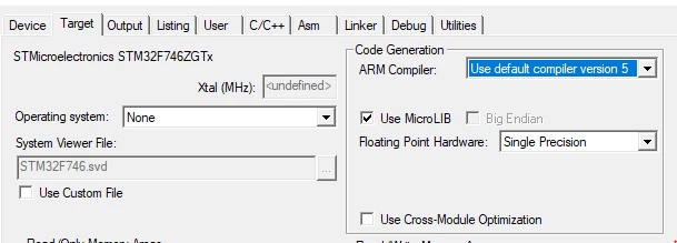

in the Keil IDE you must select ARM Compiler version 5 ... if it is not installed you must intalled it.

I already followed these steps in order to generate the project files for uVision. This is how I found out the code diffs.
I know that I can generate and use different lwipopts.h and FreeRTOSConfig.h files for each toolchain but I'd prefer to generate and use the same files for both toolchains. Therefore I use compiler directives in config files.
What about compiler V6, it seems there is no support for it in CubeMx?

for V6 we need to do futher settings.
we use (CubeIDE, IAR and MDKARM) for devlopment. i generally take care of those two steps that i mentioned before.. and it works without any issue.
