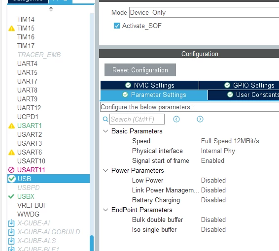

I'm creating a custom board using a used STM32H563VIT. Nice processor, but I can't understand how to create an Audo class, even if it's BT 1.0.
In the F series of processors, e.g. STM32F720, it was simple, but here it is somehow mixed up.

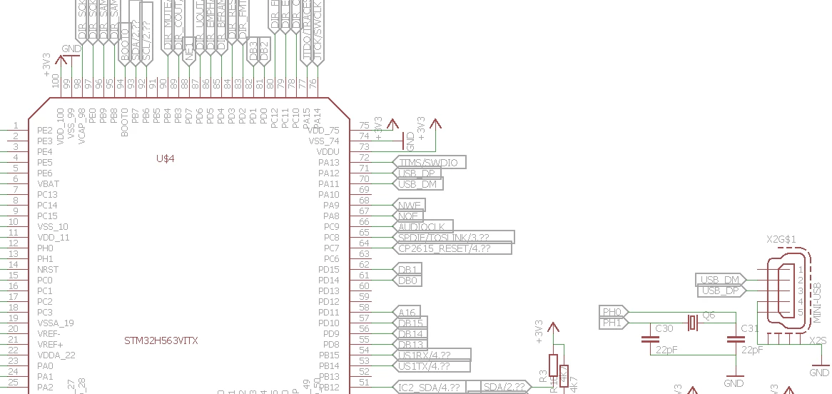

USB parts diagram:
I am trying to use a USB Adio class device.
For this reason, there is no AZURE RTOS in the IDE (H5).
I have configured the USB

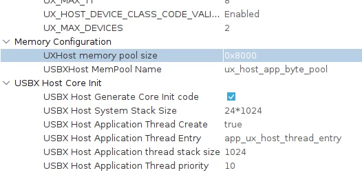

I configured USBX as FS_Device

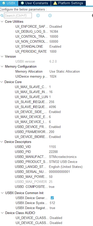

I took the stack size
After my changes
The device is in working order     HAL_PCD_STATE_READY
UINT MX_USBX_Device_Init(VOID)
UINT ret = UX_SUCCESS;
UX_PARAMETER_NOT_USED(ux_device_byte_pool_buffer);
return  ret;
However, the system does not detect the device.
What else should I do for the system to detect the device?

i made Audio host , with Azure/threadx, so its not same, but :
- i needed a lot more memory, to get it work -> so try more memory
Try enabled ... if not sure, that disabled is, what you want.
