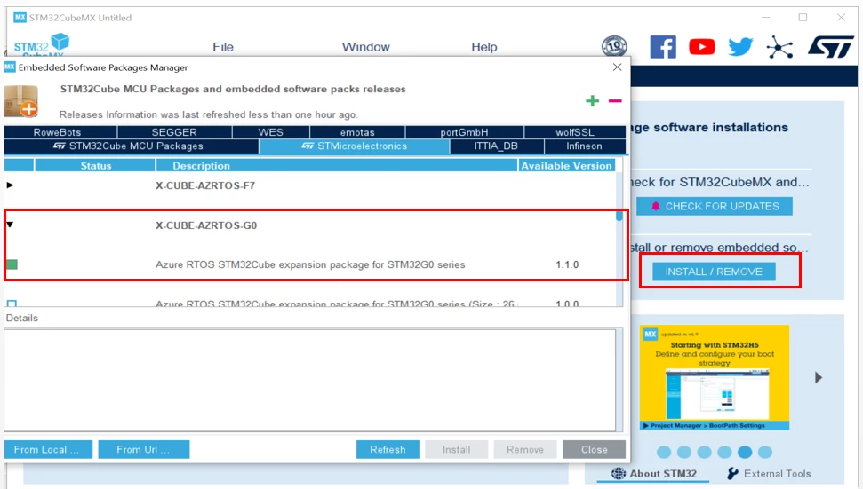

Hi Team
I am using stm32g0x mcu platform. Till now I am writing normal code without using rtos.
Does this mcu support RTOS ThreadX support in STM32G0xxx mcu platform.
Please share the process to enable using Stm32 cubeide tool.
Thanks,
Kumar

Hi @Akuma.6
Yes STM32G0xx is suppoted by ThreadX
You can find a lot of applications demo in github repo here:
https://github.com/STMicroelectronics/x-cube-azrtos-g0
You can also upload x-cube-azrtos-g0 from cubeMx and generate your code:

Hi Mohamed Ayed,
Thanks for your response.
I am using the STM32G0B1CC MCU. Will this support once again because given the GitHub have the below boards support:
  • NUCLEO-G0B1RE (MB1360-C02)
  • STM32G0C1E-EV (MB1312-A01)
Regarding my STM32G0B1CC will this support?

As you can see in the link below STM32G0xx series is support so STM32G0B1CC is also supported.
https://github.com/STMicroelectronics/x-cube-azrtos-g0/blob/a5ed457215e8aa2da134bbbdf0c2cbe0ededa5ab/Middlewares/ST/threadx/LICENSED-HARDWARE.txt#L31
Demos in the github repo is a refences application that show the integration of threadx with stm32xx product. I don't thnik that ST can provide more applications with STM32G0B1CC target.
You can start to generate a code STM32CubeMx and  x-cube-azrtos-g0  and manually port any applications.
there is a youtube video playlist show how to start azure rtos step by step
https://www.youtube.com/playlist?list=PLnMKNibPkDnGxMITHhhRqbT0-2egHq0D0
