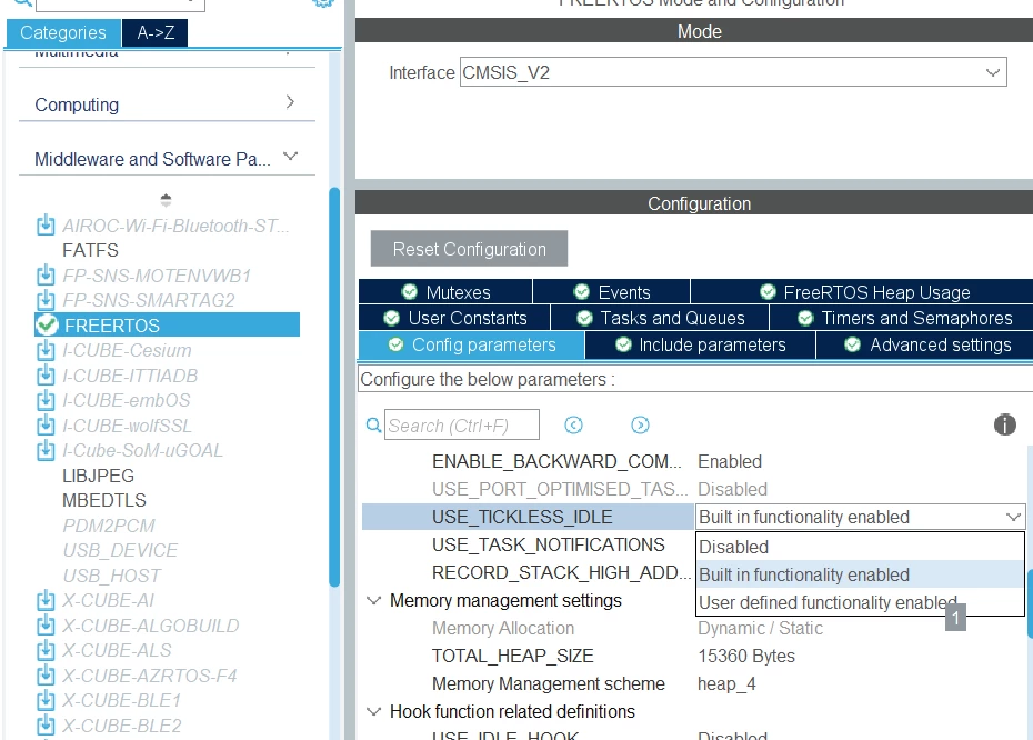

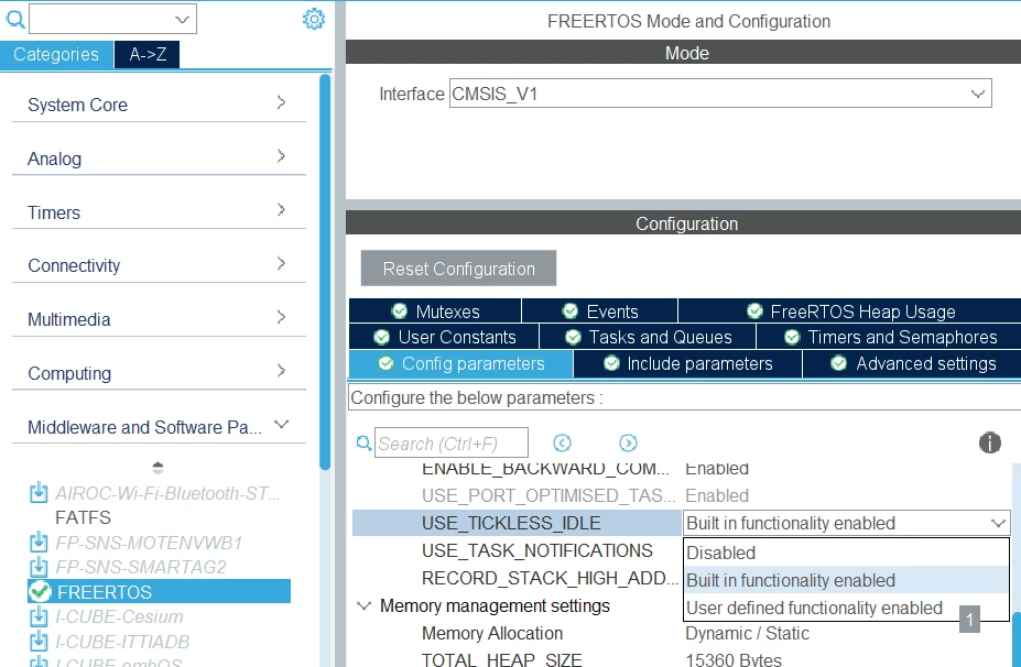

Helllo Frends,
I am workin on FreeRTOS with STM32f411CEU6 Blackpill.
In this I am facing issue with using sleep mode because there is no pin LPTIM1 in the section of TIMERS.
I tryed bothe of them CMSIS_V1 and CMSIS_V2.
Is there aany Way to use SLEEP MODE

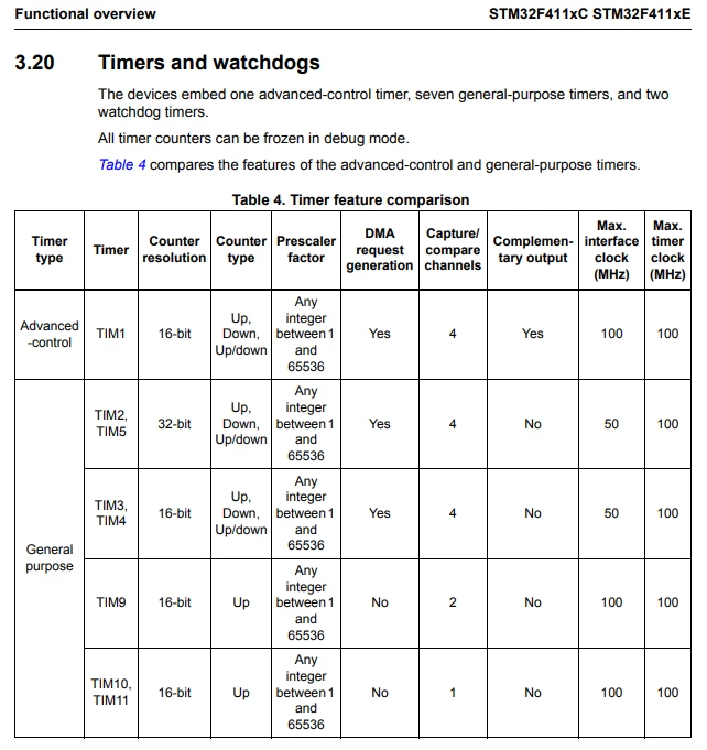

Andrew Neil
Apr 17, 2024 8:30 AM UTC
@Kai_Satone wrote:
 STM32f411CEU6 ... there is no pin LPTIM1 in the section of TIMERS.
That chip doesn't have an LPTIM1 timer:

Apr 17, 2024 8:47 AM UTC
Im hopin that there is any other way to usee sleep mode in RTOS
Andrew Neil
Andrew NeilBest answer
Apr 17, 2024 8:58 AM UTC
Use one of the timers which is available!
RTC might be an option?
The FreeRTOS documentation should cover this...
Apr 17, 2024 9:24 AM UTC
Hello @Kai_Satonen
To reach stop modes you can use LPTIM or RTC clocked by LSE... typically, the RTC has a resolution of 1 sec, which is inappropriate for most cases. it is mostly used in deeper sleep modes and not in sleep mode.
I would as well suggest upgrading to another STM32 as @Andrew Neil said the blackpills are mostly fake!
There are quite range of affordable Nucleo boards with LPTIM, for instance you can choose a NucleoL0 or L4
Andrew Neil
Apr 17, 2024 9:26 AM UTC
The "sub-seconds" might be usable ...
