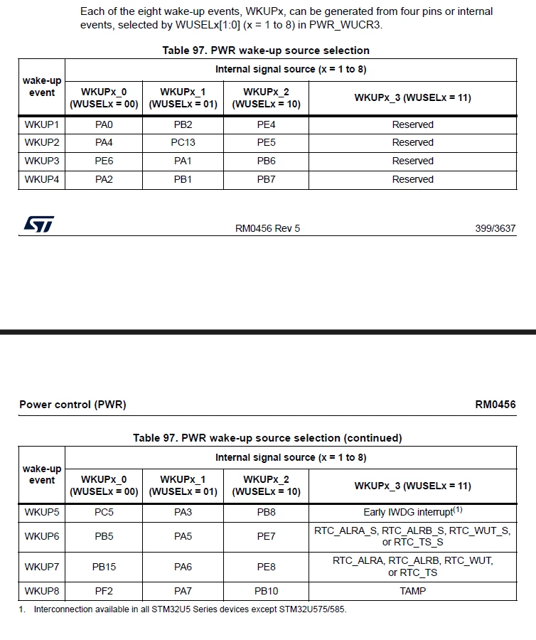

Actually, I can not find this sequence or any reference to the PWR_S3WU interrupt in that reference manual section 10.7.9.
Anyways, this enables/configures another interrupt which is used to exit from stop3. Just adding these lines does not fix my issue and my device still does not wake up from stop3.
Comparing my project with the example project in CubeMX reveals that the example project has PB15 configured as PWR_WKUP7 ("Wakeup from standby and shutdown configuration"). This configuration enables the aforementioned PWR_S3WU ("PWR wake up from Stop3 interrupt") interrupt in the NVIC page. Is this somehow related to my problem?

Visitor II
Oct 17, 2024 8:21 AM UTC
One quick update:
I found the the wakeup source selection in the manual and learned of its existance:
I also noticed that i configured the sleep duration not to 1 minute but to 30 minutes last week since i testet the sleep current. So user error on my side.
But I have on question: is the wakeup source selection required and if yes can the wakeup pins of wkup7 be used and the rtc wakeup at the same time or are they exclusive?
