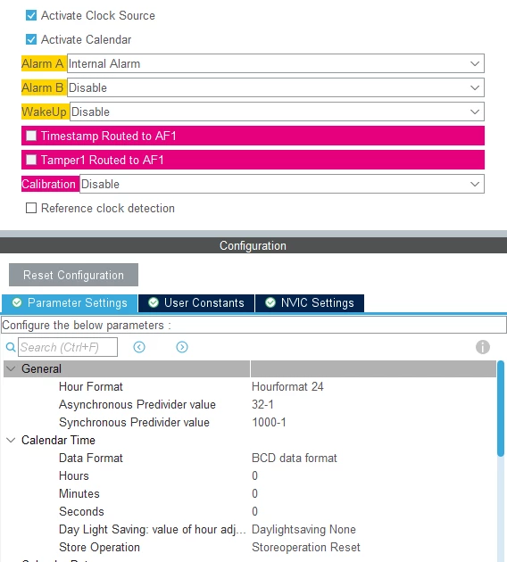

I am trying to use the RTC on a F401CCU6, but the values of the RTC don't change, and stay to what values I've set them in the IOC. I'm using the following function to get the time, and I read the values in the debugger.
RTC_TimeTypeDef sTime;
HAL_RTC_GetTime(&hrtc, &sTime, RTC_FORMAT_BCD);
The subseconds increments, but seconds and minutes don't. When I add an alarm, the alarm works correctly, triggering every second. The alarm follow the code present here https://wiki.st.com/stm32mcu/wiki/Getting_started_with_RTC.
Removing the alarm does not change anything.
I've also tried with a Nucleo f303k8, but even the alarm did not work.
Thank you for your time, I've added my configuration below.

Quite confused about why it works like that, but it works, thank you very much.
