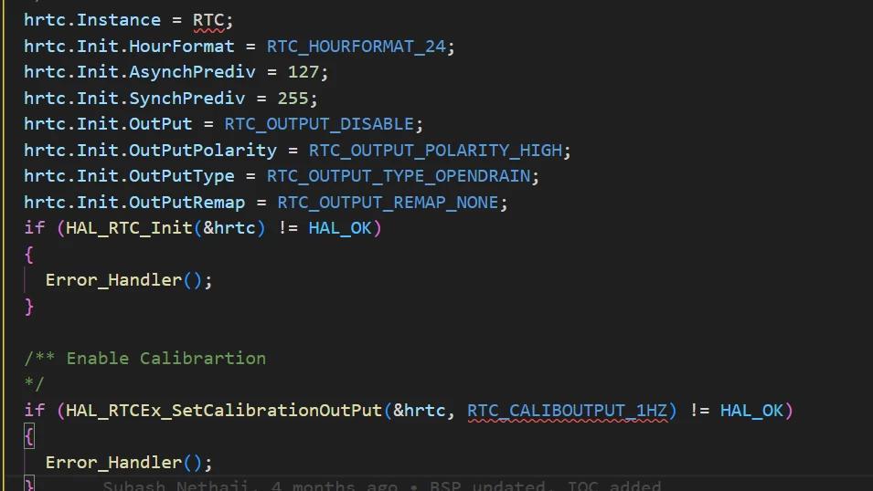

RTC loses one second after every reset
using stm32h753bitx controller and their latest HAL drivers. On the every reset RTC loses one second. It also loses time while the device in idle condition.
My devices uses main battery power and coin cell battery for backup.
Here's my RTC initialization,

Hello @Sanjay
Could you please try the solutions proposed on this GitHub issue HAL_RTC_Init() looses time · Issue #24 · STMicroelectronics/STM32CubeH7 (github.com).
Best Regards.

Iam using the latest driver which you are metioned above, But still I had the same issue.
Here's my init driver for RTC,

Could you try the workarounds suggested on this discutient (and maybe this one too)
waclawek.jan
Aug 28, 2024 11:59 AM UTC
What *year* do you set? Zero is not good.
