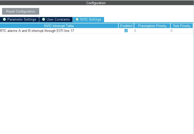

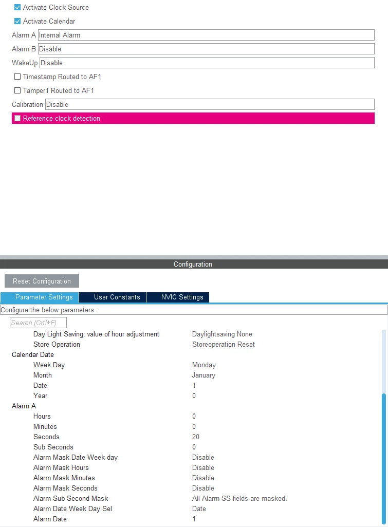

And here how i configured it in HAL

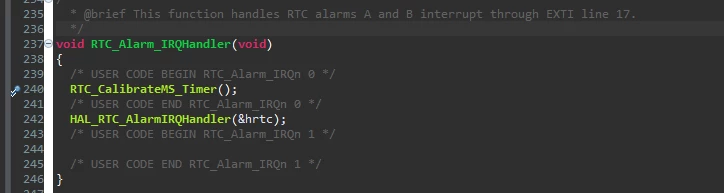

 And here I set a breakpoint in the interrupt file:

Oct 31, 2023 11:02 AM UTC
Hello @Hesseltjuuh,
Your configuration looks okay, could you specify more, what is the alarm issue exactly that you've observed?
Oct 31, 2023 2:13 PM UTC
The problem is that it doesnt trigger an interrupt, i reset my RTC so the RTC and Alarm should match each other perfectly after i boot it on but it never triggers an interrupt.
Tinnagit
Senior II
Oct 31, 2023 12:07 PM UTC
It's about Alarm Mask.
Alarm Mask is used for ignore that field to compare with your alarm time.
As your config, You have no mask in any field so RTC are going to alarm on every 0:0:20.000 on Monday.
and If you want to alarm at second 20th every minute, you should try to mask in another field except second field.
RTC is going to compare your alarm time in second field 20th to RTC time in second field and alarm if it matched.
Oct 31, 2023 2:14 PM UTC
I know but i also reset my RTC so the date and alarm should match without the masks. (i also tried it before with the masks enabled but didnt work either)
Sarra.SBest answer
Oct 31, 2023 4:52 PM UTC
Hello again @Hesseltjuuh,
The RTC's current time and date should indeed match the alarm time and date.
Please refer to this article which is made for seconds.
You should still  mask hours and days for it to work in the long run as @Tinnagit already said.

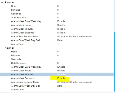

Jan 27, 2024 4:00 PM UTC
I too am having trouble with getting interrupts on seconds.   I have set two alarms, one for 00:00:00 on alarm A, and that works, toggling the LED, but the seconds alarm never fires.  I am guessing I have not set up the handlers correctly.  The NVIC is checked.  The above mentioned article appears to be a help, but I am not getting there.
Here is my stm32l4xx_it.d
void RTC_Alarm_IRQHandler(void)
 /* USER CODE BEGIN RTC_Alarm_IRQn 0 */
 /* USER CODE END RTC_Alarm_IRQn 0 */
 HAL_RTC_AlarmIRQHandler(&hrtc);
 /* USER CODE BEGIN RTC_Alarm_IRQn 1 */
 /* USER CODE END RTC_Alarm_IRQn 1 */

Attached are my alarm configureations.  I tried the seconds mask both ways, enabled and disabled with no difference.
