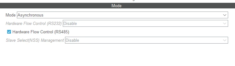

Hi @abhijith_raj
In order to use USART1 in RS485 mode, you have to call HAL_RS485Ex_Init() API (instead of HAL_UART_Init()).
You also need to configure your DE pin as Alternate Function (in addition to TX/RX pins).
You could also use STM32CubeMX, which will generate initalisation code for your project, if you prefer :
Then you should be able to find generated code in main.c and stm32g4xx_hal_msp.c files.
Regards

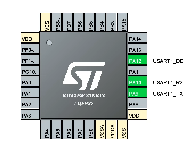

May 15, 2025 4:52 AM UTC
Hi @Guenael Cadier ,
In this configuration, the PA12 pin is used for DE control. However, in our schematics, this pin is assigned for a different purpose, so we’ve selected another GPIO for DE. How can I control the DE line in this case? Can I use HAL_GPIO_WritePin to manually control the GPIO for each transaction?
Guenael Cadier
May 15, 2025 7:07 AM UTC
Hi @abhijith_raj
If you can't assign a pin for USART1_DE as Alternate function, then it means it cannot be driven automatically by USART1 peripheral. then, I think it should be feasible to initilialize USART1 in classic Asynchronous mode (HAL_UART_Init()) and drive your DE pin manually in your application using HAL_GPIO_xxx APIs.
