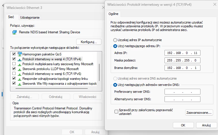

  2. I set network in Windows for Remote NDIS:
  - Deactivate IPv6 and activate IPv4 mode
  - Static addresses as follows:
                - Address = 192.168.0.11
                - Network Mask = 255.255.255.0
                - Gateway = 192.168.0.1
  - Automatic DNS and Routing deactivated.

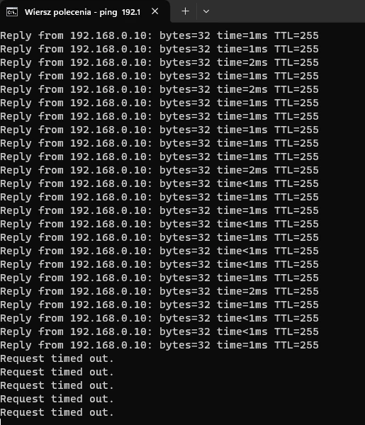

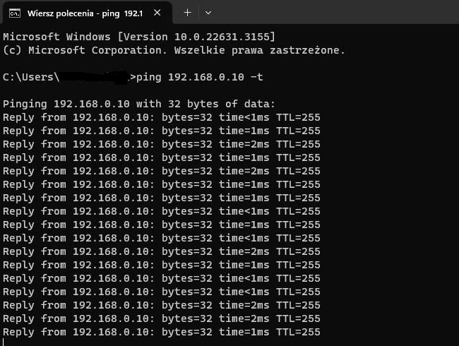

  1. I opened command line and created ping request „ping 192.168.0.10 –t”. It works ok.

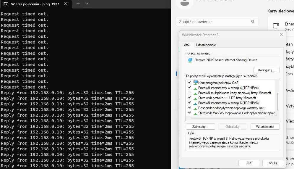

  1. I reconnected usb in PC. Ping doesn’t work. I still have „Request timed out”:
To restore communication I need to change the network settings. I have to set IP6 active and click OK.
Why is communication restored after IP6 activation? I think than communication should start after connect USB to PC. Can you explain to me what is the problem ?

Hi @pferd
After several tests, I couldn't reproduce. It appears that deactivating and then reactivating IPV6 allows the target and the host to restore communication without any issues.
