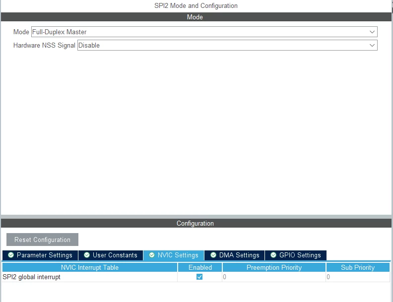

Regarding SPI communication using DMA and manual SPI_CS operation
We are performing SPI communication using DMA.
In this case, we manually set the GPIO to High/Low as SPI_CS, but (obviously) SPI_CS goes High before all of the SPI CLK is sent.
How can we manually return SPI_CS to its original state after all of the SPI CLK has been sent?
Should We use SPI_DMATransmitReceiveCplt?
Saket_OmBest answer
Dec 23, 2024 2:39 PM UTC
Hello @pass3master
  1. You need to set the SPI global interrupt in the .ioc.
  2. In your code call HAL_SPI_TransmitReceive_DMA() and then set CS high in the HAL_SPI_TxRxCpltCallback().

Dec 23, 2024 9:56 AM UTC
SPI_DMATransmitReceiveCplt is not called. Is there something we need to set? Do we need to set the ioc file?
Andrew Neil
Dec 23, 2024 10:10 AM UTC
Have you enabled the interrupt?
Dec 23, 2024 1:17 PM UTC
You should set CS high in HAL_SPI_TxRxCpltCallback.
If that's not working, show the relevant code. Ensure DMA interrupts are enabled.
